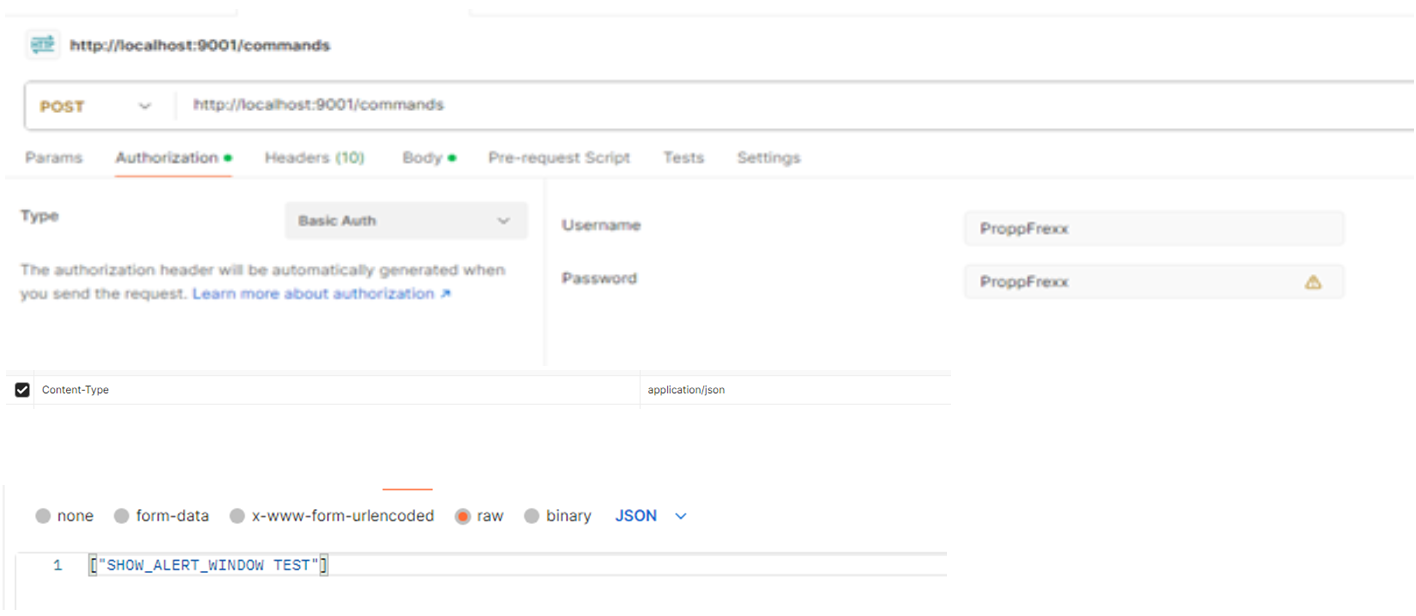

The GPIO client on my Windows Server runs on port 9001.
When I execute this command in curl I see:
PS C:\Users\Admin> curl.exe -X POST http://localhost:9001/commands `
>> -H "Content-Type: application/json" `
>> -d "[`"SHOW_ALERT_WINDOW TEST`"]" `
>> -u ProppFrexx:ProppFrexx -v
Note: Unnecessary use of -X or --request, POST is already inferred.
* Host localhost:9001 was resolved.
* IPv6: ::1
* IPv4: 127.0.0.1
* Trying [::1]:9001...
* Connected to localhost (::1) port 9001
* using HTTP/1.x
* Server auth using Basic with user 'ProppFrexx'
> POST /commands HTTP/1.1
> Host: localhost:9001
> Authorization: Basic UHJvcHBGcmV4eDpQcm9wcEZyZXh4
> User-Agent: curl/8.13.0
> Accept: */*
> Content-Length: 24
* upload completely sent off: 24 bytes
However, no message shows up in ProppFrexx (it is enabled in settings and options -> More Stuff).
Could it be that I did something wrong? Any suggestions on how I can troubleshoot or fix this problem would be greatly appreciated. Thanks in advance.

Thanks for your quick response. I tried the following:
PS C:\Windows\system32> curl.exe -X POST http://localhost:9001/commands `
>> -d "SHOW_ALERT_WINDOW TEST" `
* IPv6: ::1
* IPv4: 127.0.0.1
* using HTTP/1.x
> Accept: */*
> Content-Length: 22
* upload completely sent off: 22 bytes
After the message “upload completely sent off: 22 bytes” curl hangs.
I also tried the same request with Postman (with and without the brackets). In both cases, Postman shows “Sending request” and then hangs.
Additional information: I have a Java Spring application that sends messages to the REST API. It works on another computer, but on this new computer it also hangs when sending a message to the REST API.
I hope you can help. Thanks in advance.

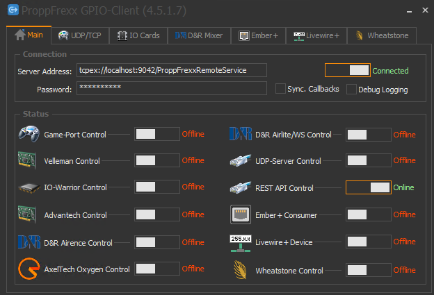

This is really strange. I copied the old version 4.4.1.3 to the new computer and it worked once. After I changed the password in the GPIO client and General Settings, Postman returns a 401 unauthorized message, no matter what password I use (the old or the new).
The new version also has this issue
viewtopic.php?p=20083&hilit=GPIO+client+password#p20083
All of this probably doesn’t make sense. I’ll have to investigate this further.
Re: REST API
I don’t understand ‚that‘ issue. What issue is it?
The config is saved when you exit the application. But the password is only relevant for the connection between the GPIO client and ProppFrexx OnAir.
Maybe you should reboot your PC? Is there maybe a second process running somewhere in the background?

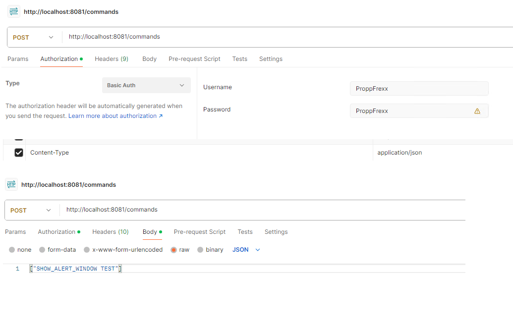

Here is some information about the current situation on the new production computer.
The GPIO configuration file:
<add key="RESTAddress" value="http://localhost:8081/" />
When ProppFrexx is not running:
PS C:\Windows\system32> netstat -ano | findstr :8081
No results from netstat, so port 8081 is free.
When ProppFrexx is running:
TCP 0.0.0.0:8081 0.0.0.0:0 LISTENING 4
TCP [::]:8081 [::]:0 LISTENING 4
Then I run a test with Postman by deliberately sending a wrong password.
As expected, I get a 401 Unauthorized message, which I think proves that the GPIO REST API is responding.
After that, I test again with the correct password, but Postman (or curl) hangs indefinitely.
Debug logging is enabled, but nothing appears in the debug log. When Postman hangs, netstat shows this:
TCP [::1]:8081 [::1]:54337 CLOSE_WAIT 4
TCP [::1]:54337 [::1]:8081 FIN_WAIT_2 9832
Here are the Postman settings:
