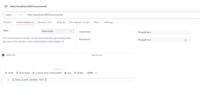

Thanks for your quick response. I tried the following:
PS C:\Windows\system32> curl.exe -X POST http://localhost:9001/commands `
>> -H "Content-Type: application/json" `
>> -d "SHOW_ALERT_WINDOW TEST" `
>> -u ProppFrexx:ProppFrexx -v
Note: Unnecessary use of -X or --request, POST is already inferred.
* Host localhost:9001 was resolved.
* IPv6: ::1
* IPv4: 127.0.0.1
* Trying [::1]:9001...
* Connected to localhost (::1) port 9001
* using HTTP/1.x
* Server auth using Basic with user 'ProppFrexx'
> POST /commands HTTP/1.1
> Host: localhost:9001
> Authorization: Basic UHJvcHBGcmV4eDpQcm9wcEZyZXh4
> User-Agent: curl/8.13.0
> Accept: */*
> Content-Length: 22
* upload completely sent off: 22 bytes
After the message “upload completely sent off: 22 bytes” curl hangs.
I also tried the same request with Postman (with and without the brackets). In both cases, Postman shows “Sending request” and then hangs.
Additional information: I have a Java Spring application that sends messages to the REST API. It works on another computer, but on this new computer it also hangs when sending a message to the REST API.
I hope you can help. Thanks in advance.

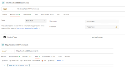

Re: REST API
I realize this is probably a mistake on my part, but it has already cost me a lot of time.
Is paid support on a no cure, no pay basis an option?
Here is some information about the current situation on the new production computer.
The GPIO configuration file:
<add key="RESTAddress" value="http://localhost:8081/" />
When ProppFrexx is not running:
PS C:\Windows\system32> netstat -ano | findstr :8081
No results from netstat, so port 8081 is free.
When ProppFrexx is running:
TCP 0.0.0.0:8081 0.0.0.0:0 LISTENING 4
TCP [::]:8081 [::]:0 LISTENING 4
Then I run a test with Postman by deliberately sending a wrong password.
As expected, I get a 401 Unauthorized message, which I think proves that the GPIO REST API is responding.
After that, I test again with the correct password, but Postman (or curl) hangs indefinitely.
Debug logging is enabled, but nothing appears in the debug log. When Postman hangs, netstat shows this:
TCP [::1]:8081 [::1]:54337 CLOSE_WAIT 4
TCP [::1]:54337 [::1]:8081 FIN_WAIT_2 9832
Here are the Postman settings:
