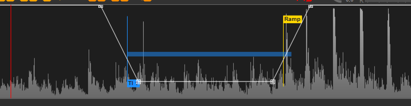

Hi Bernd, after the latest update, Propp is cutting off voice jingles inserted into the intro before the ramp. What could be causing this?
Posts: 8975
Re: Cutting the jingle in track insert mode
Nothing was changed in that respect.
Can you specify the issue in more details and maybe provide an example (sample files and a playlist) - as I seem to be not able to reproduce it.
How do you ‚insert‘ those jingles, what transition are you using.
Here is a small audio test I made using the End with Ramp Of Next Track transition. In the audio you first hear the jingle by itself and then the resuting track insert - as you can hear and also see below, nothing was cut off.
https://www.proppfrexx.radio42.com/shar ... tTrack.mp3
Make sure, that no NextTrack or CueOut cue-point might limit the playout of the jingle:

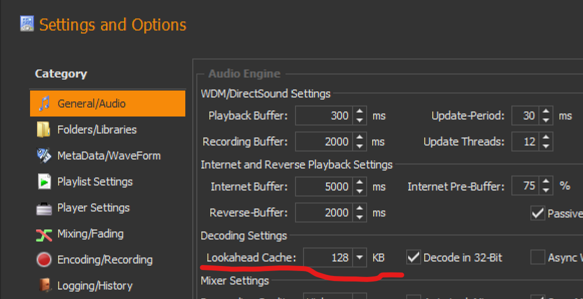

Thanks for the test file. As with this exact test file I could reproduce the issue.
It is related to an async read option within the audio lib I am using. I also reported the issue to the developer of the audio lib to fix.
To quickly fix the issue on your side without waiting for a new version, you can change the setting of the async read option in ProppFrexx.
Either disabling it or setting it to a value different to 64KB will solve the issue. I'll provide an update as soon as the audio lib is fixed.
djbony
Posts: 276
Joined: 13 May 2014 08:11
Post by djbony »
Thanks a lot. Changing the Lookahead Cache helped.
