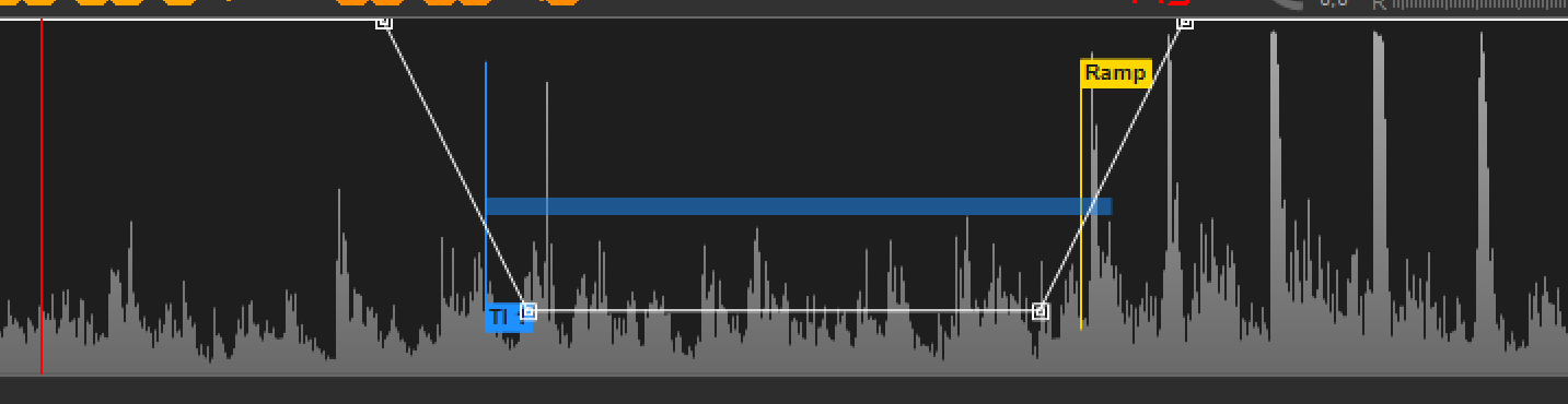

Here is a small audio test I made using the End with Ramp Of Next Track transition. In the audio you first hear the jingle by itself and then the resuting track insert - as you can hear and also see below, nothing was cut off.
https://www.proppfrexx.radio42.com/shar ... tTrack.mp3
Make sure, that no NextTrack or CueOut cue-point might limit the playout of the jingle:

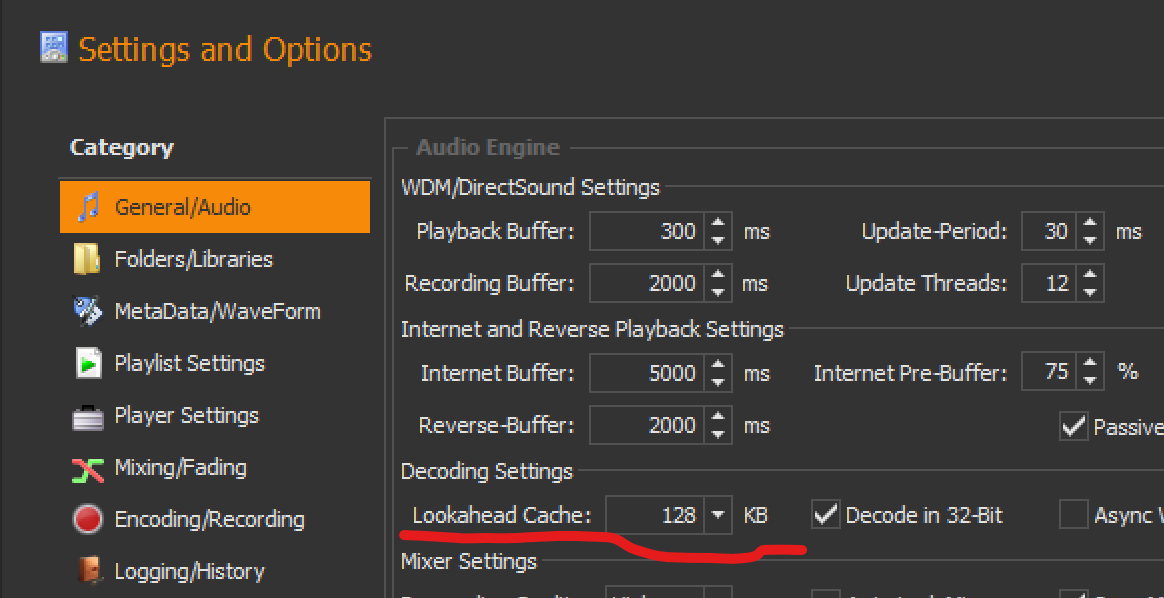

Thanks for the test file. As with this exact test file I could reproduce the issue.
It is related to an async read option within the audio lib I am using. I also reported the issue to the developer of the audio lib to fix.
To quickly fix the issue on your side without waiting for a new version, you can change the setting of the async read option in ProppFrexx.
Either disabling it or setting it to a value different to 64KB will solve the issue. I'll provide an update as soon as the audio lib is fixed.

Thanks a lot. Changing the Lookahead Cache helped.
