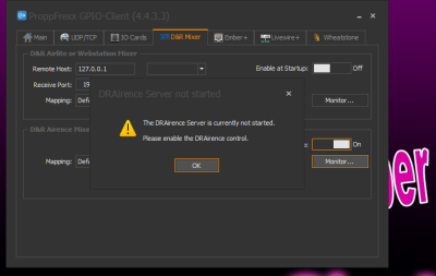

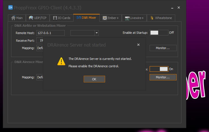

I have the following question: I cannot join/set my DR Airance mixer in the first screen of the GPIO.
In the second screen I get the message as in the photo, what am I doing wrong
Kind regards, Bob van Dongen

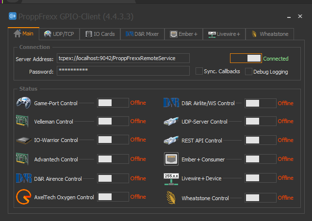

I cannot enable the D&R Airance control in the GPIO

Maybe you are already using another (Airence ) app in parallel? That’s the only case I so far heard, why it could not connect, as the Airence only allows one app to use the API to it.
Or you are using a USB hub or defect USB cable.

When I connect the mixer to my old PC, which I was able to work well with until a few days ago with the Gpio connection, it still works well now.
But it doesn't work on my new PC where I installed Proppfrexx yesterday.
Could it be that it doesn't work because I have the mixer connected to a USB 3.0 connection? I no longer have 2.0 USB connections.
I cannot transfer the D&R Airance choice to online
