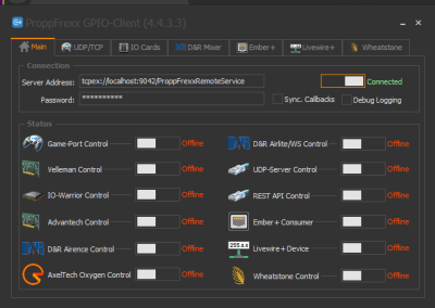

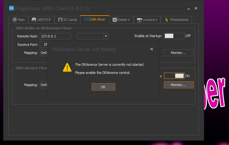

Hello all
I have the following question: I cannot join/set my DR Airance mixer in the first screen of the GPIO.
In the second screen I get the message as in the photo, what am I doing wrong
Kind regards, Bob van Dongen

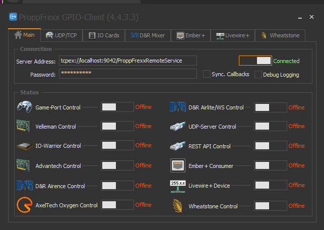

Re: DR Airence Server not started
Thanks for your response
I cannot enable the D&R Airance control in the GPIO
