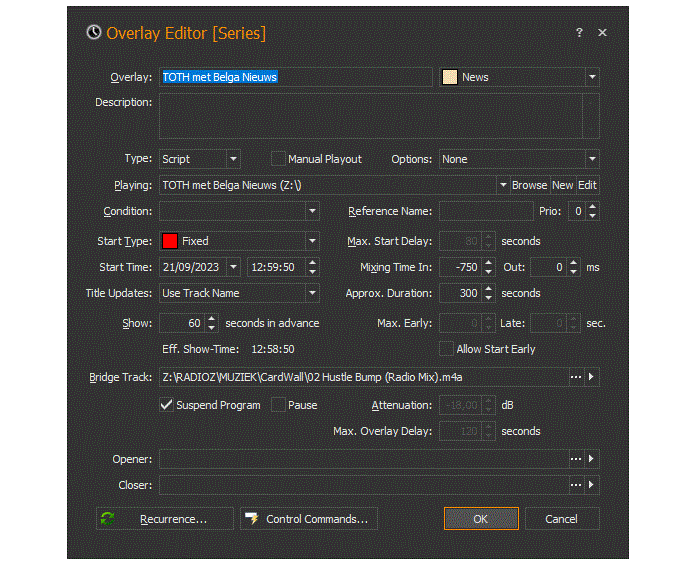

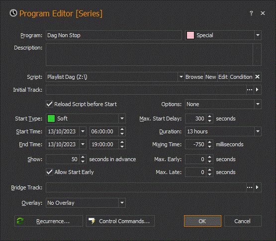

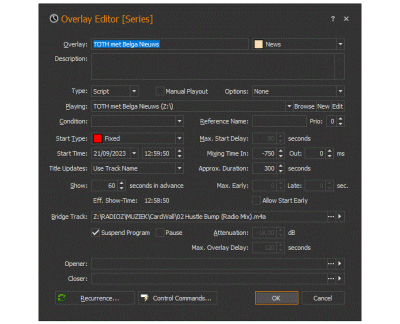

Can you the send your configuration how your program(s) are defined and how the overlay(s) are defined... maybe screenshots of each.
THX
Bart ve
Posts: 35
Joined: 13 Jul 2023 22:50
Re: Auto Play doesn't resume after TOTH
Post by Bart ve »
see files attached, B.
