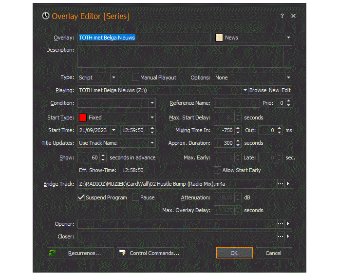

Can you the send your configuration how your program(s) are defined and how the overlay(s) are defined... maybe screenshots of each.

see files attached, B.

That looks very strange indeed. To investigate what is going on and try to find a possible root cause, please
