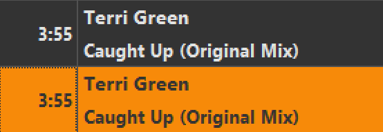

What exactly have you done? Maybe you haven't saved the cue-points to the TAG data?
On my side it is working.
Here is what I did to test it:
a) I have loaded two same tracks (files) to a playlist
b) I changed the cue-points of the first file (total length changed from 4:01 to 3:55)
c) I saved the cue-points (Save MetaData TAG) of that first file
At this point the 2nd file obviously and by design did not change its length (the cue-points are still the previous ones)!
d) now I selected all files (CTRL+A) and Re-Read the TAG data (CTRL+ALT+T)
Now all files changed in the length - also the 2nd file
Please always also describe your exact steps, else I cannot reproduce your issue.

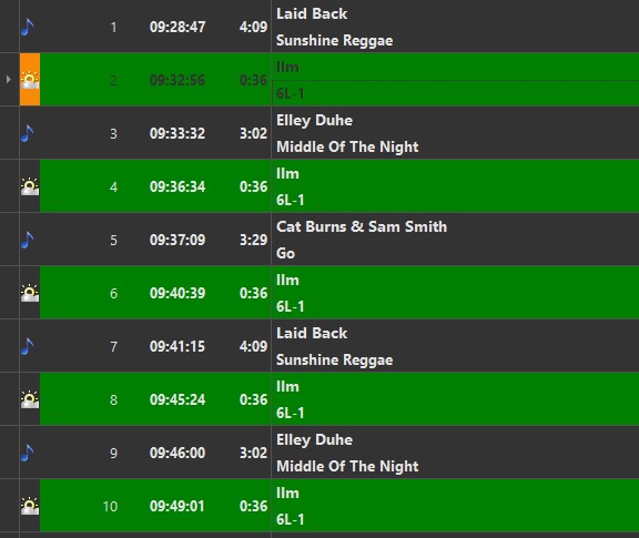

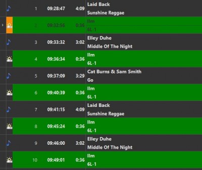

I did to test it:
1) I have loaded two same tracks "Ilm -6L1" to a playlist
2) I changed the cue-points of the first file (total length changed from 0:36 to 0:34)
3) I saved the cue-points (Save MetaData TAG) of that first file
