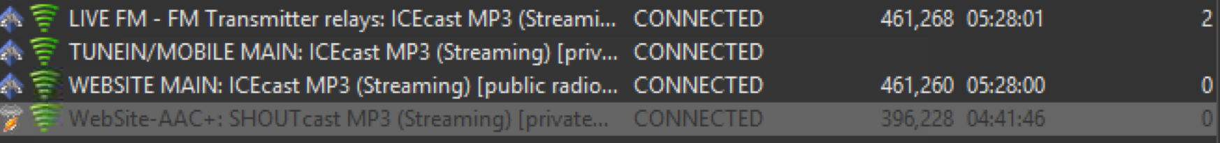

Columns:
Server and Status always displays.
Send(KB), Up Time, and Listeners stop after so many hours.
For example it’s stopped again on all 4 connected servers this morning and been showing the following all day:
Website AAC+ SHOUTcast(Streaming)... CONNECTED
396,228. 04:42:06. 30
The other 3 are ICEcast and say. CONNECTED 461,264. 05:28:00
So it obviously disconnected a different time for some reason but the stats got stuck some hours later.
The only way to get it going is by stopping and restarting all servers. Just stopping and restarting one does not resolve the issue.

I noticed a missed off the listeners from ICEcast.
Yes, it’s stops updating the time, Sent data and current listeners not matter if it’s ICEcast or SHOUTcast
The above stats I posted have been the same all day, and just waiting for a quiet time to restart the servers again.
Just to add that the stream continues encoding as normal after the stats( Sent(KB), Time, Listeners) stop updating.

TO save confusion I've attached a screen shot of the server monitor. It's changed to one of them not displaying any live stats now. Just the name and connection status. The stats you see in the attached image have been the same all day(frozen) as posted before, but now one of them has gone blank.
Hope this makes it clearer for you.
