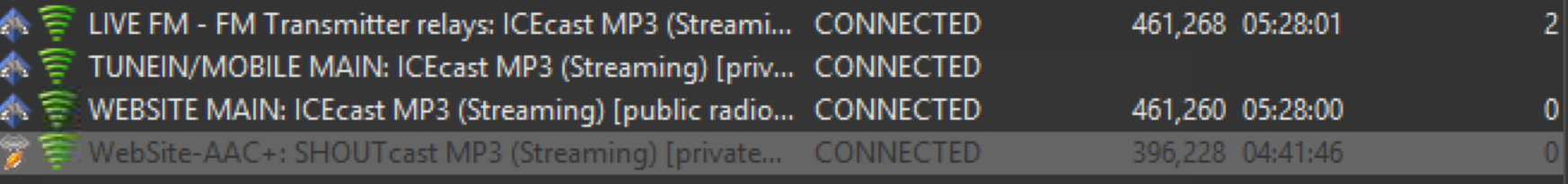

TO save confusion I've attached a screen shot of the server monitor. It's changed to one of them not displaying any live stats now. Just the name and connection status. The stats you see in the attached image have been the same all day(frozen) as posted before, but now one of them has gone blank.
Hope this makes it clearer for you.
Posts: 9108
Re: Network Streaming Monitor status not updating
I still would have no clue how this could ever happen.
Can you please do the following - once this happens again... - when it happens, than:
- go to the general settings, section More Stuff and enable the option 'Debug Logging'
- close the general settings and wait a few seconds (5-10 sec. should be good)
- go to the general settings, section More Stuff and disable the option 'Debug Logging' again!
Now you should find in your ProppFrexx AppDataUser folder a Debug_....log file (for the current date and time).
Please send me this file - maybe it contains more valuable info about a possible reason.
