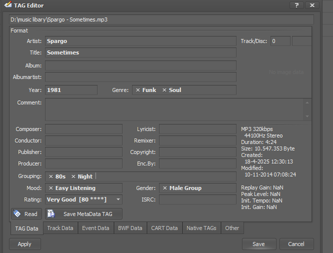

Tnks thats what i mean, its grouping also possible to set time, type and target?. or juste one of these examples.
Re: grouping and mood
Yes.
You can define in the grouping, genre, mood, gender, style any many other fields multiple values. Just press enter after each selected value. A small ‚x‘ appears to even remove one of multiple values entered.

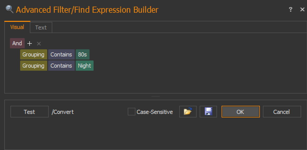

Are thise to many tags, is it also possible when i grouping make : 80s and Night.
Thise is a slow song, its easy but quit possible.
When i make an script with 80s on day, can i then also only in the night set this song as a night song, or is onlye 80s or night possible there.
Being honest, I hardly understand what you are trying to say.
But you can make different Filter options for a script-line. E.g.
a) Grouping contains '80s'
b) Grouping contains '80s' AND Grouping contains 'Night' I guess b) is what you mean?

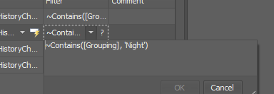

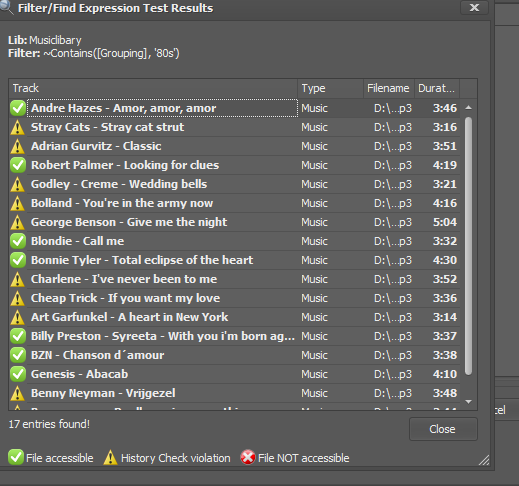

Thise is possible or correct way to do?. for a night script between 01:00 - 04:00....
Your test above uses a 'Grouping contains 80s' Filter. If this is what you want, it looks correct. Not sure, what exactly you want.
So yes, all is possible.
