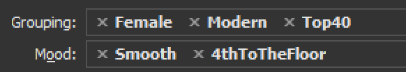

Is there an list what possible is on grouping and mood, i want try it i have 1300 tracks now in one map.
does anyone screenshots for it or can help. i have currently deutsche music playing. bud in grouping can i add tag boyband, and on mood also?
correct me if i wrong.

Yes, these are general purpose fields.
You can list any labels, names, keywords whatsoever in there.
Just separate the keywords eg. by a semicolon.
For later filters, you can then use the ‚Contains‘ filter.
So make sure to use mutual exclusiv keywords.

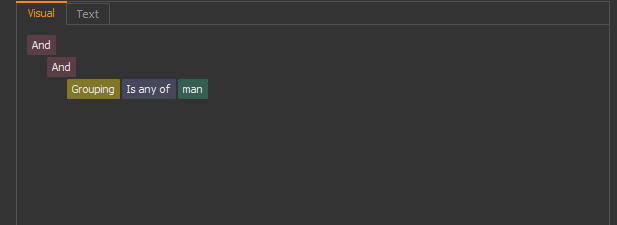

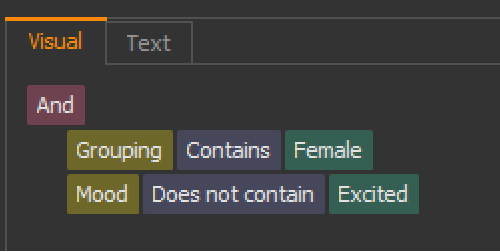

You define the values which you want to use - you cannot make a video about it.
Here is an example:
Separate the entries by eg. semicolon to enter multiple values: And the use a Filter with the contains comparison:
Here is an example:

Take the following example:
You want to make sure, that in a certain script-line a track from a female artist with a mellow mood is played… so you specify those criterias as a filter for your track selection for that script-line (assuming you have tagged your tracks accordingly).
So what exact video do you need?
