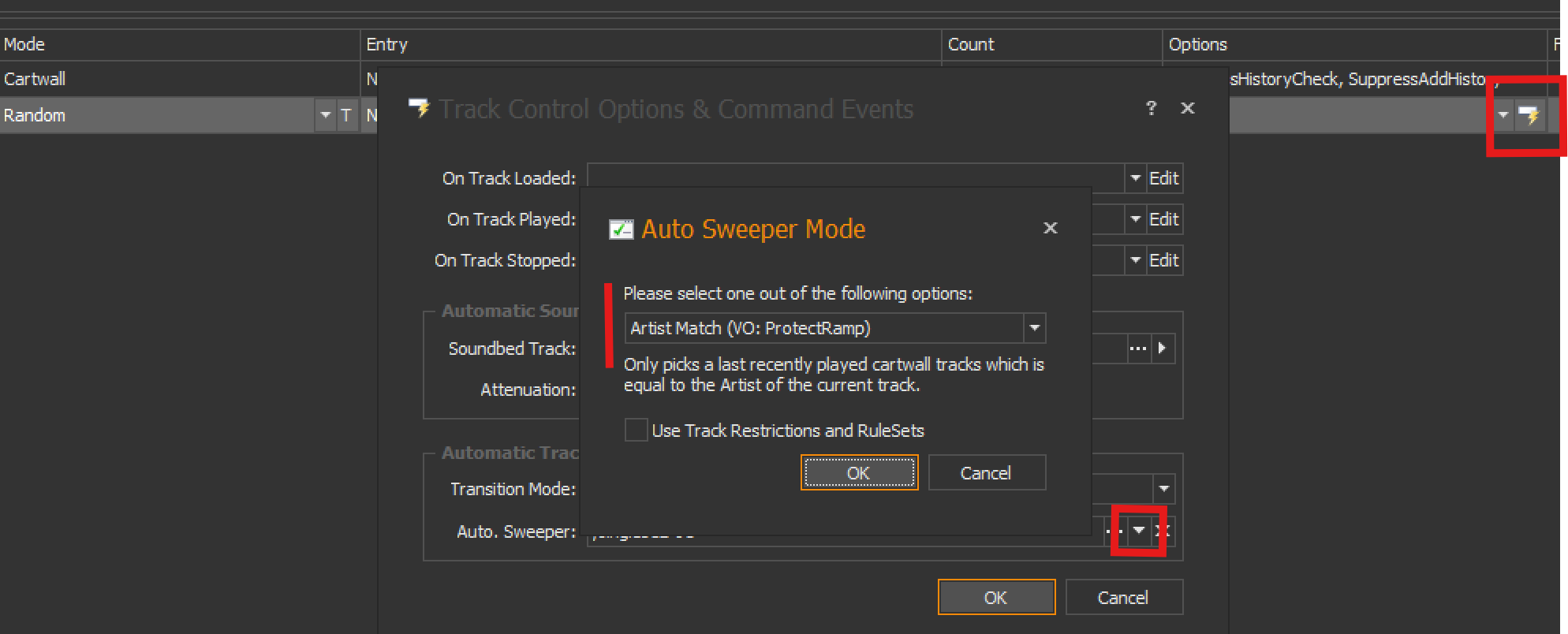

2) is called 'Automatic Sweepers' and is related to artist (and is an option of a script-line):
- it selects a random track from the cartwall library, but filters the cartwall with ONLY tracks matching the same Artist! This allows picking (if available) an Artist related intro sweeper, eg. to announce/feature the Artist.
- it always uses the given transition, eg. if the Artist intro is too long (longer than the ramp time of the audio), the sweeper stays as a dedicated track within the playlist, else it will fit til the RAMP time. In your case (2 minutes) such sweeper would play as a separate track. The following image shows where you define it (click on the small arrow in the Options column of a script-line):
