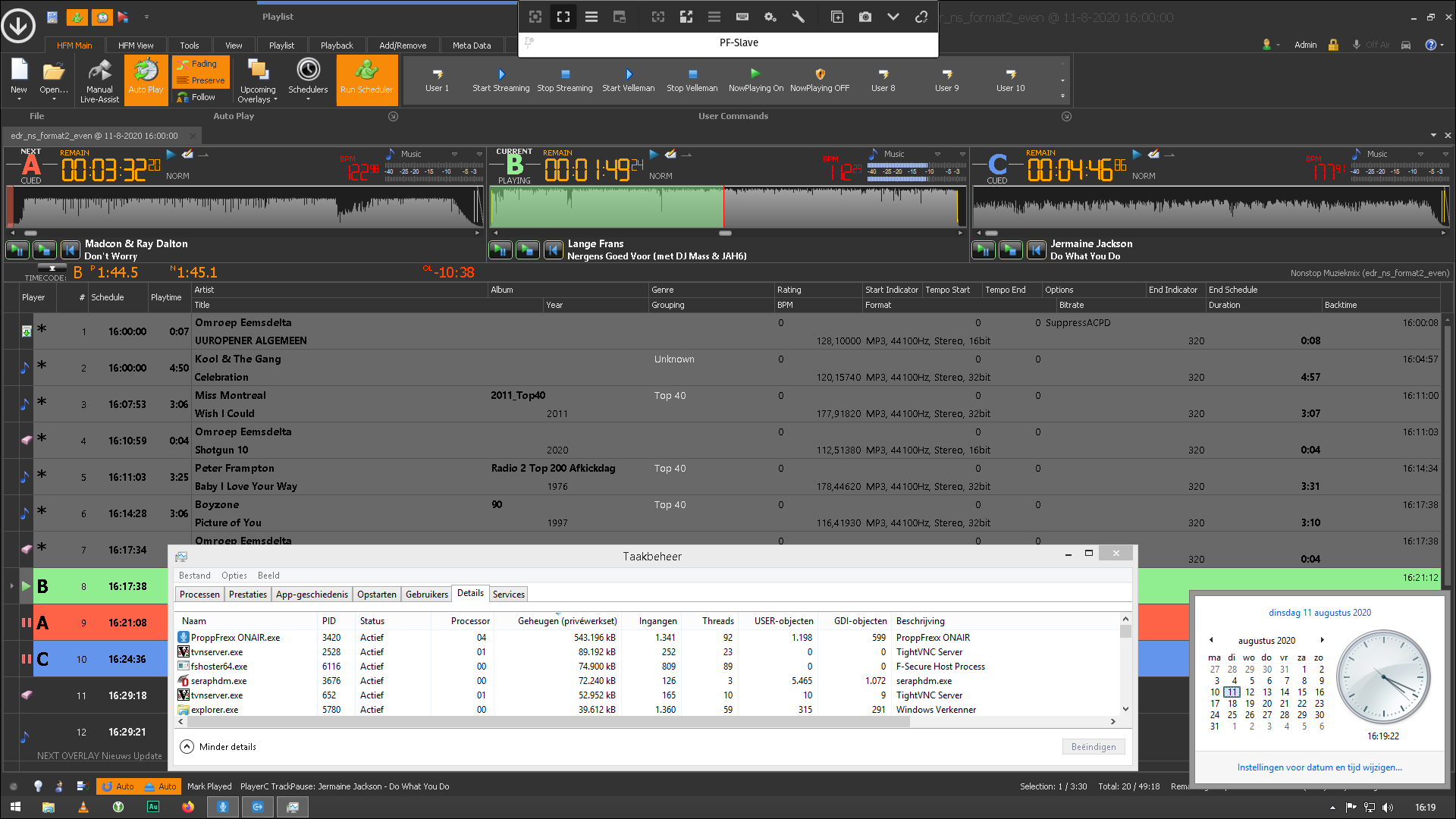

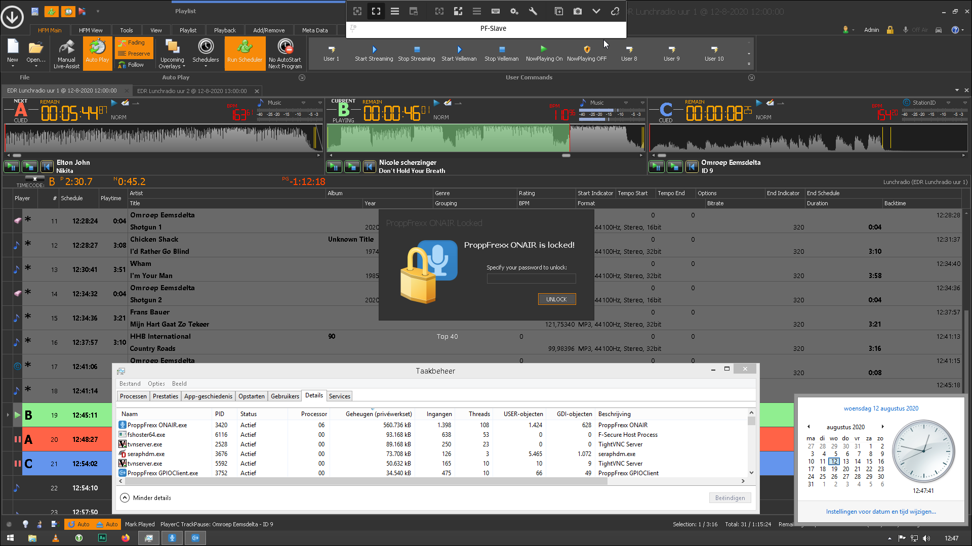

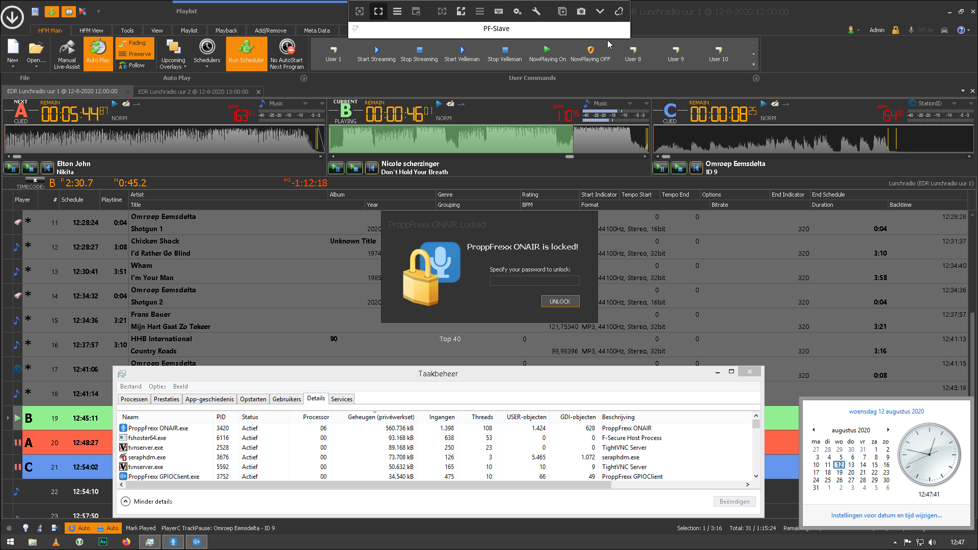

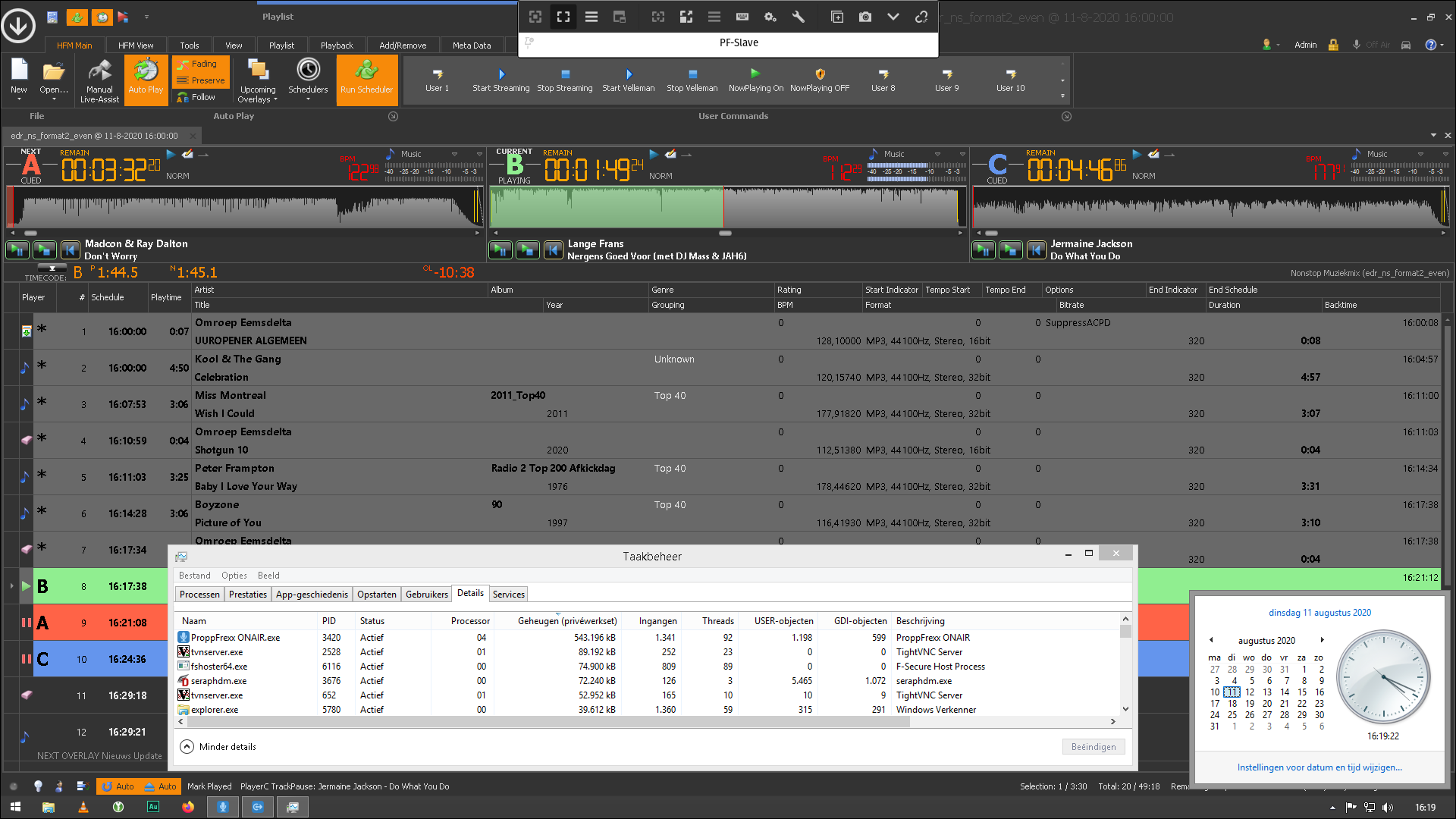

Thought to show You the results in the included screenshots. Without UAC in approx. 20,5 hours just a memory increase of 17,5 MB.
With UAC PF would have crashed already.

A certain memory increase up to 400MB followed by a certain up and down even up to 200MB is totally fine. That really depends On the use and configuration.
But not a constant increase up to multiple GB!
So it seems somehow related to your UAC setup.
However, I cannot reproduce that on my systems.
I guess I would have to ask you to send me a zip of your entire config folder, ie. the ProppFrexx AppUserData folder.

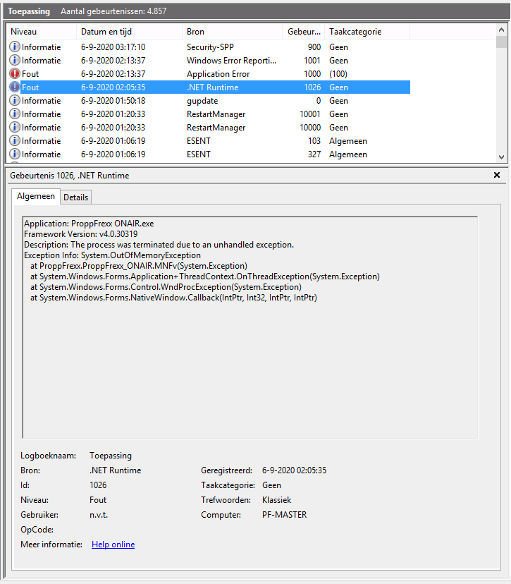

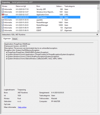

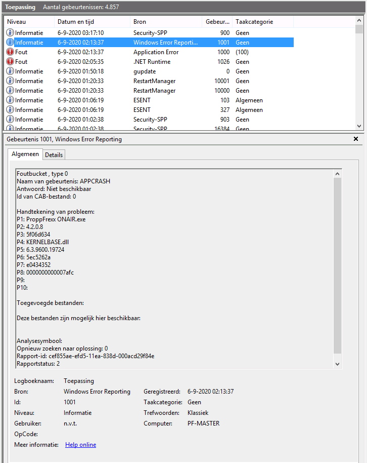

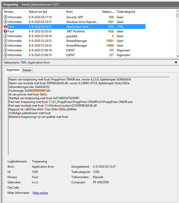

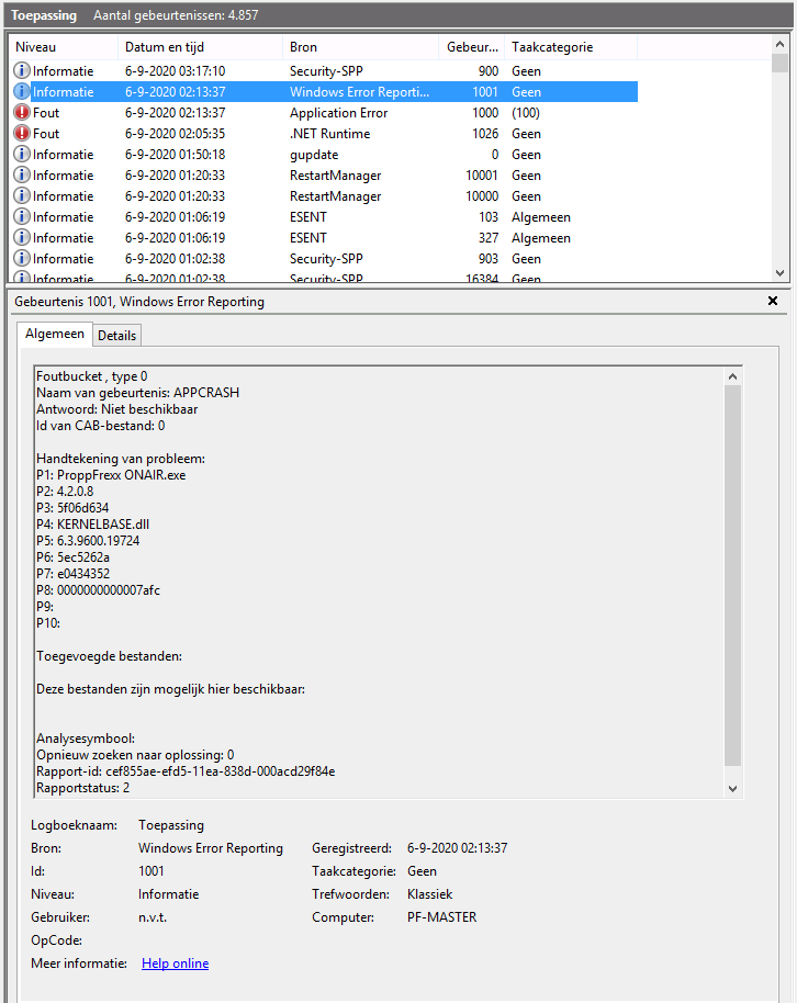

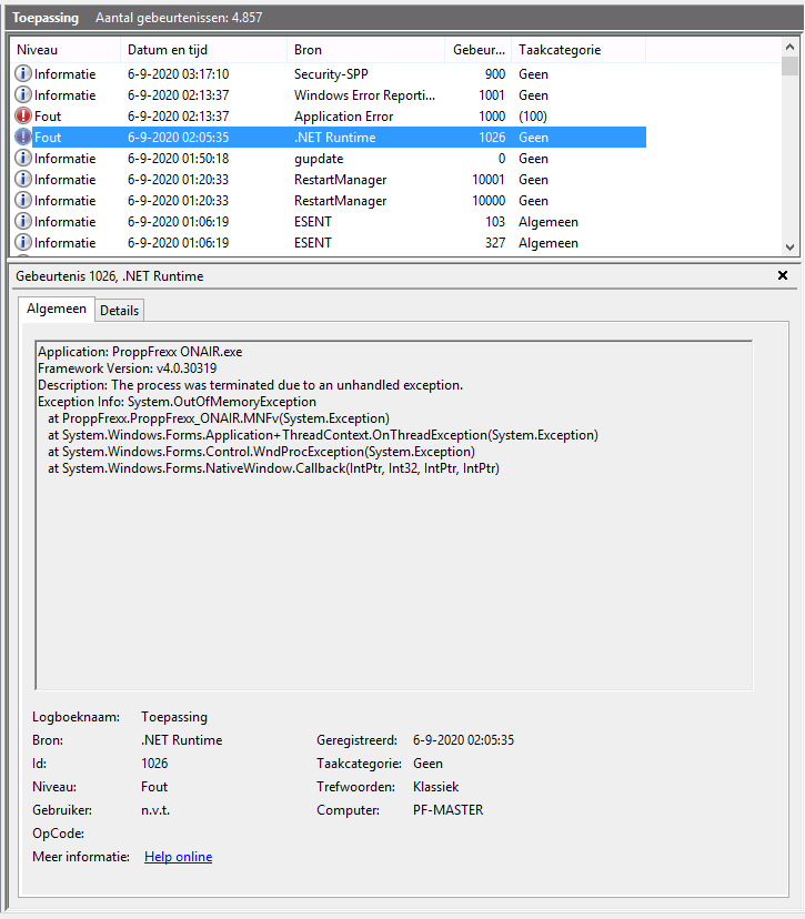

Unfortunately the problem returned.
As You can see in the attached screenshots from the windows log PF crashed last night at approx. 02:05 hrs. There is no entry in the PF error log file, only in the windows application log. And only when i woke up this morning i could restart PF. Our station has been off air in between.
At this moment i can see the memory filling up again.
So what changed? Only thing i can think of is that the system was restarted yesterday morning around 09:15 hrs. And as this was the first restart after the replacement of the router windows did ask the Defender question 'Do You want this computer to be discoverable by other computers on your network?' which i answered with yes. After that moment the memory problem appeared again.
Apparently the problem is both network related and also uac related?
Regards, Jack.
Regards, Jack.
