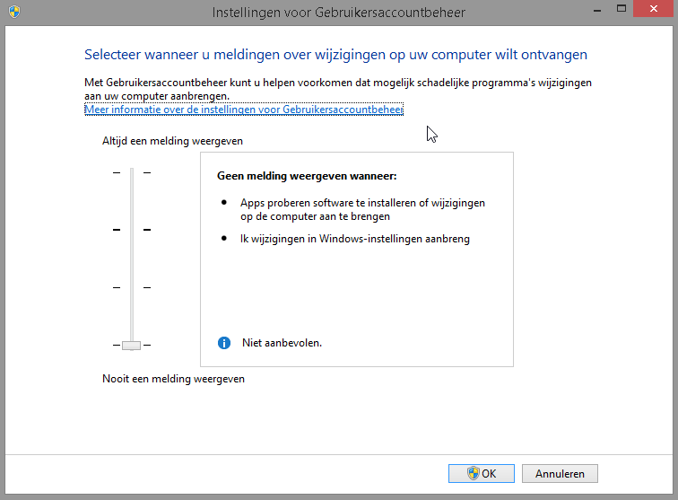

Can you do me a favor and temp. disable UAC on your machine on which the Memory increases so quickly and check, if that stops the increase of memory?!
If it would still increase (even if UAC is disabled) this would be a sign, that we must continue searching elsewhere.

UAC is off, this does not change a thing. Or do you mean hacking the registry?

No, I did mean the UAC option within ProppFrexx, which disables the internal user management.
