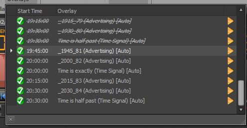

Also I create an recurring time announce overlay starting 20:00 and show 70 seconds in advance.
In adv pattern wizard I create the slots overlays also starting at 20:00 and show 68 seconds in advance.
Which will play first? Because in Overlays screen appear first the adv overlay and next the (time announce) overlay.

g) Two or more overlays should by default use a different start time! Else their execution order is NOT guaranteed!
So I setup a time announce overlay at 00 and +30 minutes with start early 90 secs in advance
Then I setup slots and overlays in adv manager starting +02 min and start early 90 secs in advance too.
Do I have to setup also Program Start Time 90 secs in scheduler settings ? I think yes because in my testing there were times where the time announce played then a song and then a new program started.

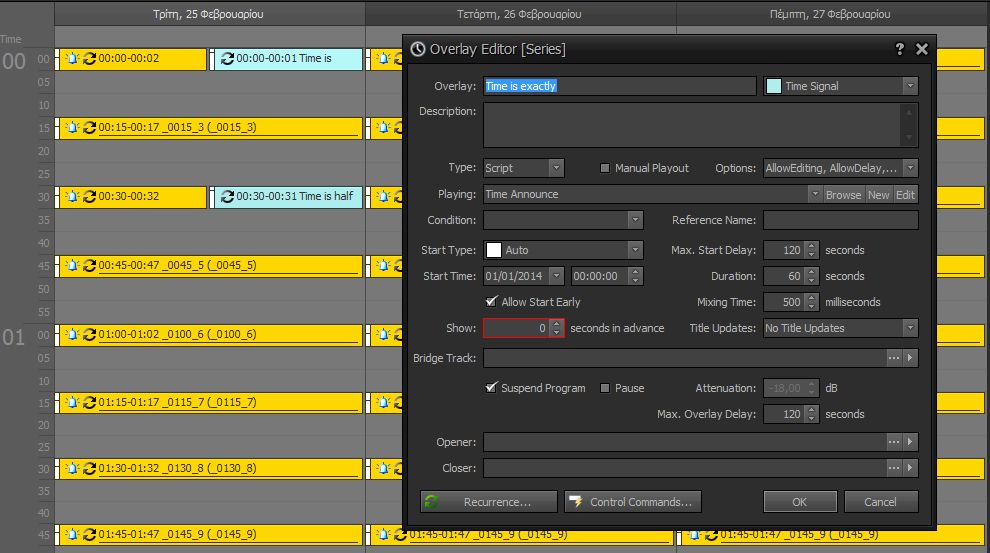

f) "Delete Slots":
Yes, that works correct and as designed: When a slot is deleted and you specified to also delete the associated overlays...then ALL those overlays which are using/referenceing that slot are deleted - of course this doesn't make any difference whether or not the resp. overlay was created manually or by the wizard!
The show in advance field always shows a value of 0 in case that overlay was already triggered by the Overlay Scheduler (see ProppFrexx OnAir)!
This in order to ensure, that not by mistake you accidentally tigger it twice!
That is also the reason why it is highlighted by a red box - to make it really visible to you - that in case you want to trigger it again, you would have to specify a new in advance time manually!
When giving different show in advance times they might effectively be executed in the order which shows up first!
But by design, each overlay should have a unique start time!
I.e. if they should run in parallel (see the 'Combine Parallel Overlays' within ProppFrexx OnAir) simply specify start times which just differ by 1 second to exactly define their execution order.
