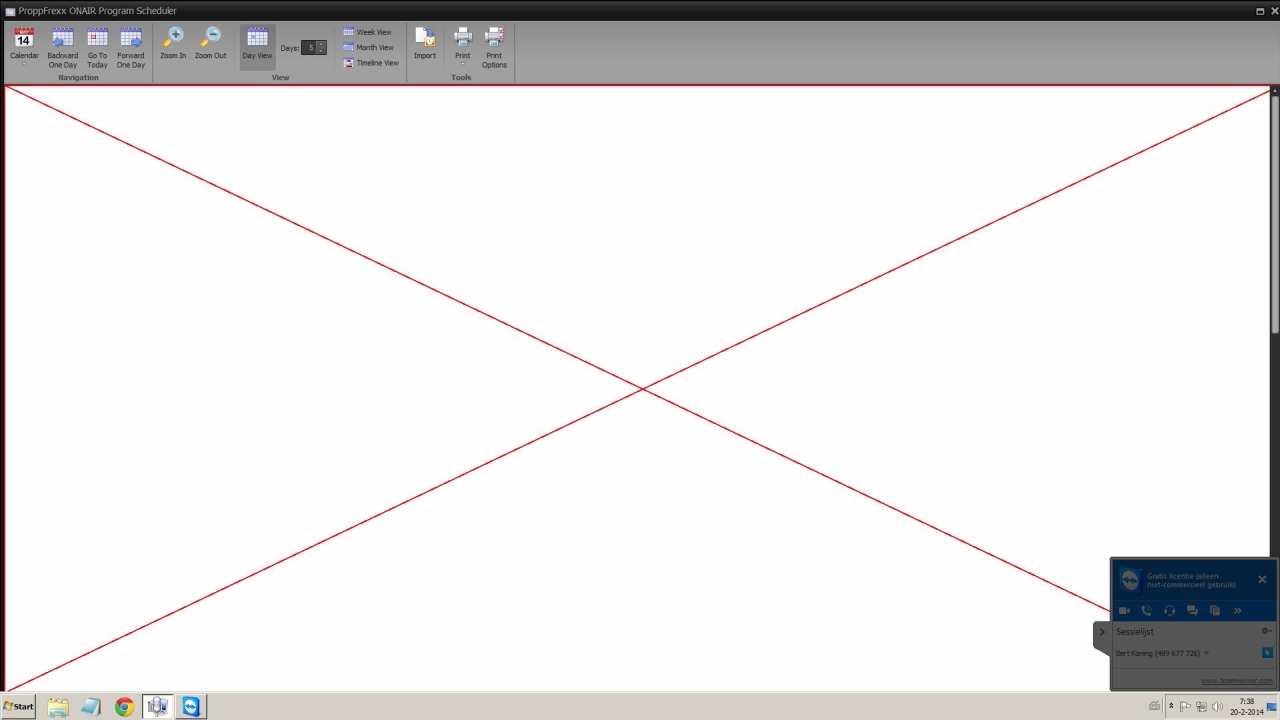

When opening the scheduler (admin account) in PF latest version (3.0.12.13) everything seems normal.
But when I change the viewing days from 3 to 5 I get a big red cross, see screenshot.
To get rid of that big red cross I have to close the scheduler and than turn off off the green "man" scheduler and than turn it on again to get my scheduler back.
I read something it has to do with a graphic card or .NET.
I think this must be a PF bug, otherwise I couldn't get my scheduler back when turning off and turn it on again.
When I go open scheduler again all settings are back, but when I try to change the viewing days the red cross is back again.

- Scheduler error
- Scheduler_error_admin.jpg (134.59 KiB) Viewed 13103 times

Re: Scheduler bug, big red cross when changing viewing days
I would have no idea where this error comes from.
Could also be a corrupted .Net Framework installation.
I can absolutely not reproduce the error - especially it shouldn't have anything to do if the Scheduer is running or not, as the Scheduler View is totally independent of it.
It might also be an out-of-memory error...
Did you try rebooting your system?
OKi - let me know, if this happens again...
Could also be caused by a (hidden) Windows Update in the background...

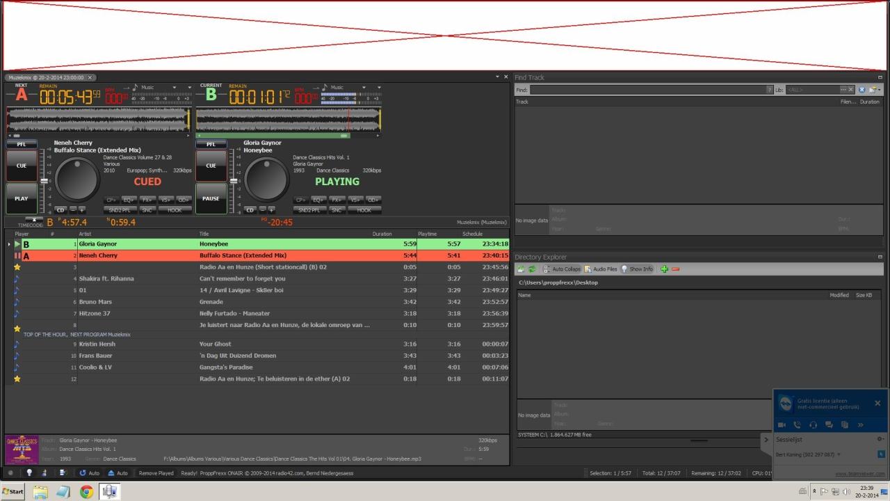

Tonight we received a new red cross in our standard useraccount (limited rights).
- New red cross...
- Red_Cross_Standard-Useraccount.jpg (96.81 KiB) Viewed 13093 times
