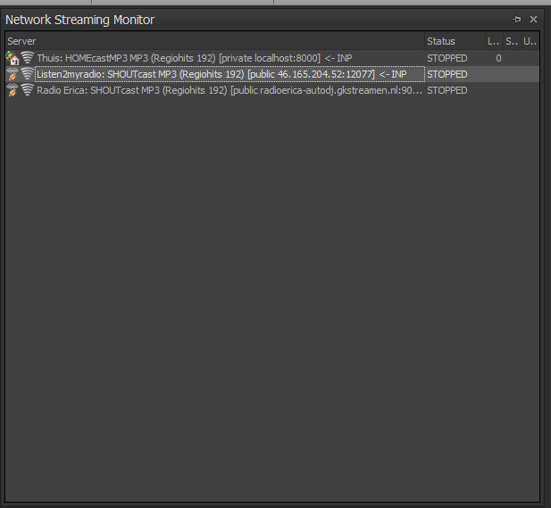

- I also have a test stream, and that works fine with meta data
- teststream.jpg (30.64 KiB) Viewed 14104 times

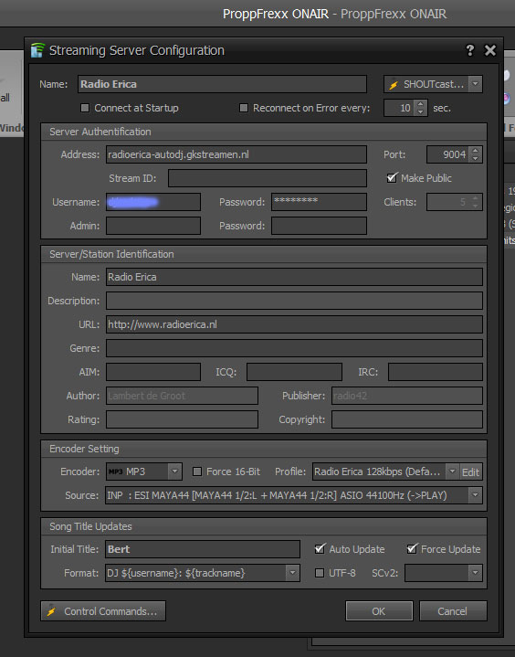

- The settings
- Settings.jpg (69.79 KiB) Viewed 14104 times
Re: Playing now not working
As said above:
Note: If you do not use this instance for online streaming make sure that you provide the admin username/password above, as some streaming servers require the admin password for offline title updates.
You have NOT set the fields Admin username and password !
Please set them accordingly...and try again.
