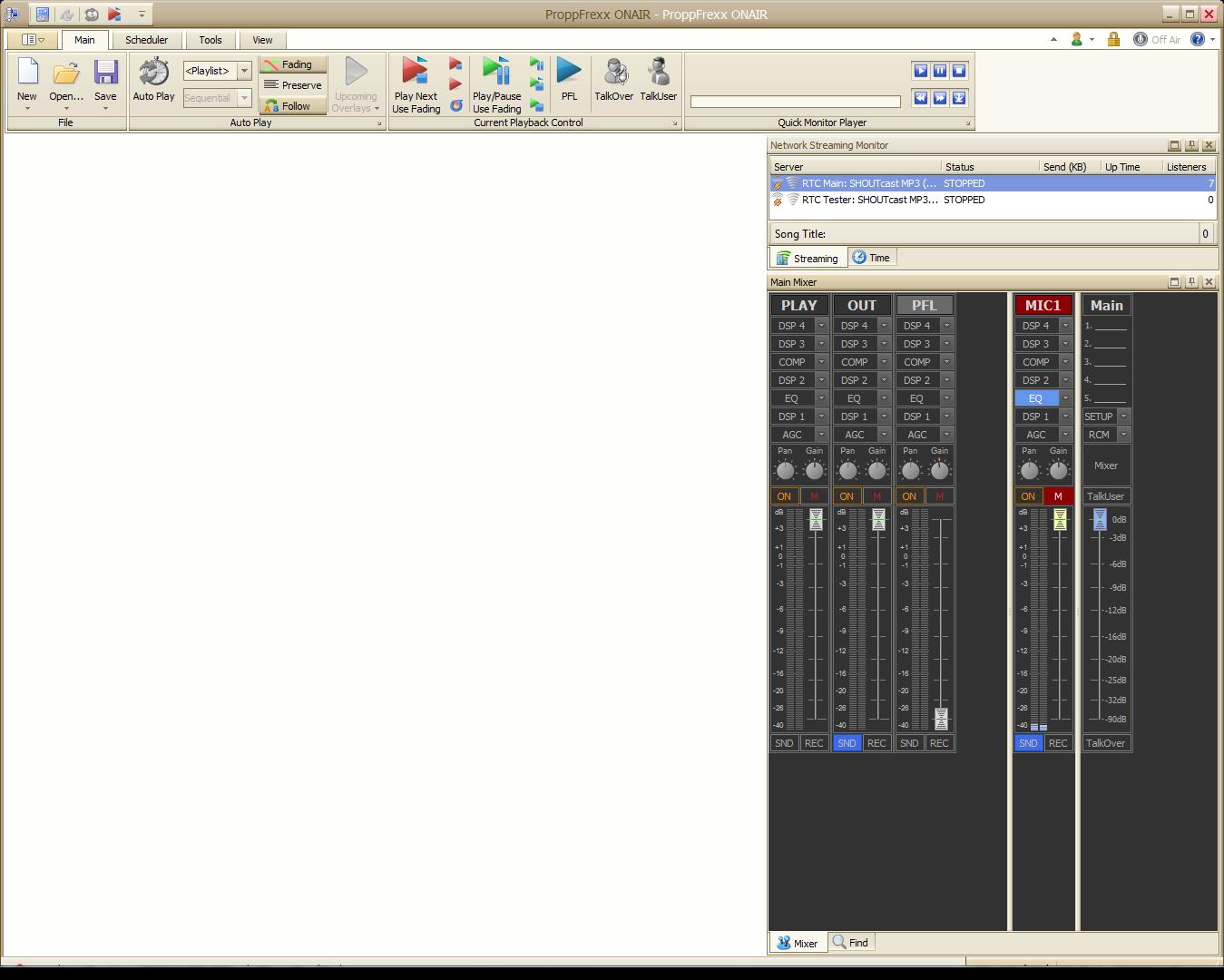

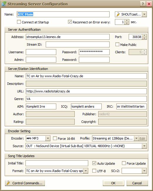

Re: PFOA stoppt nach 30 Min.
Servus,
ich hab mal einige Screenshots gemacht und hoffe die helfen weiter, wenn nicht einfach die richtigen bestellen

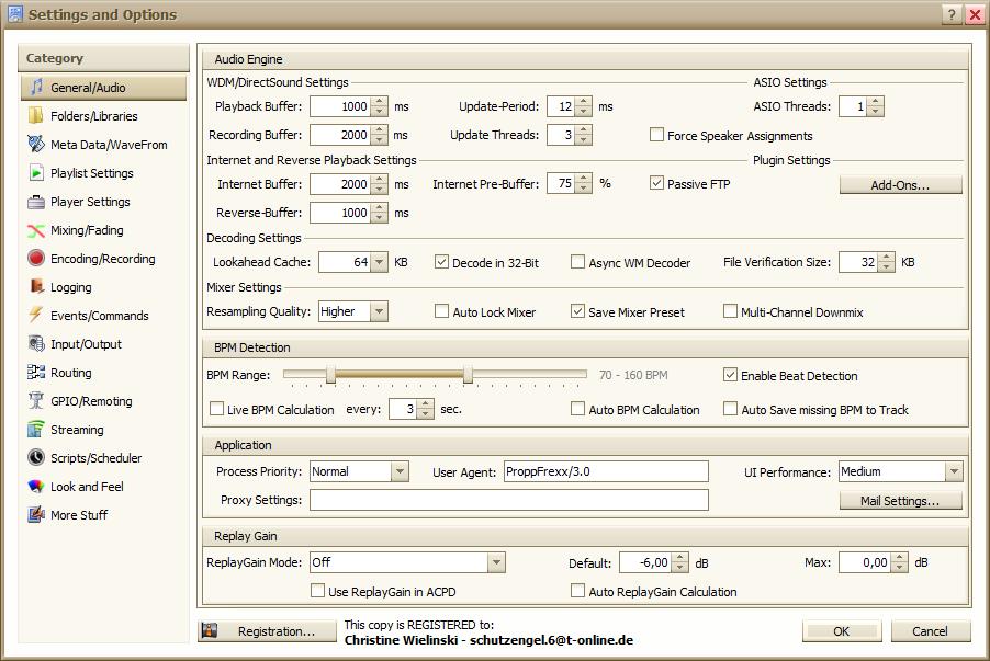

A couple of things:
- Playback Buffer should be 300 ms
- Update Period should be 30 ms
Further set your OUT mixer channel to 41000Hz as you are streaming in that sample rate.
Don't you have a real sound card available? As your OUT mixer channel is a virtual one?! If available please try using a real sound card.
Then some more questions:
What MP3 encoder are you using eg. click on the 'Edit' button next to the encoder Profile in the streaming server dialog and then double-click on the MP3 entry
Also in the general settings under Encoding/Recording please click on the 'Encoder Setup' button.
