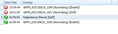

The scheduled start time of an 'ending at' or a soft overlay is not shown, as far as I can see ?
Upcoming Overlays.jpg (75.19 KiB) Viewed 16811 times
Re: End of an hour fill option
For the 'EndsAt' option the effective ending at time is displayed - I'll see, if I can also display the effective start time accordingly here.
However, for the 'Soft' option the planned start time is displayed - the effective start time can of course NOT be calculated, as the currently playing track's remaining time for a future event can not be predicted at that time ;-)
andrerotgans
Posts: 192
Joined: 27 Nov 2012 13:23
Post by andrerotgans »
I understand, and as stated in my original question, I'm not interestend in the soft overlays. That's the nice thing of them, the softness ;)
However, if you can add the effective start time to the endsat overlay, that would be welcome !
The EndsAt time display should now work in v3.0.11.48.
