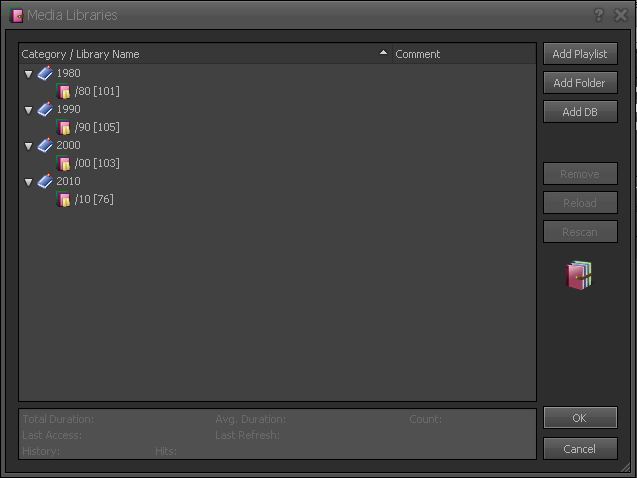

i have divided all my library how u can see:
Cattura media library.PNG (21.21 KiB) Viewed 12235 times
so i like to have possibility to select main category so i can have more than once source for category (more than one nas)

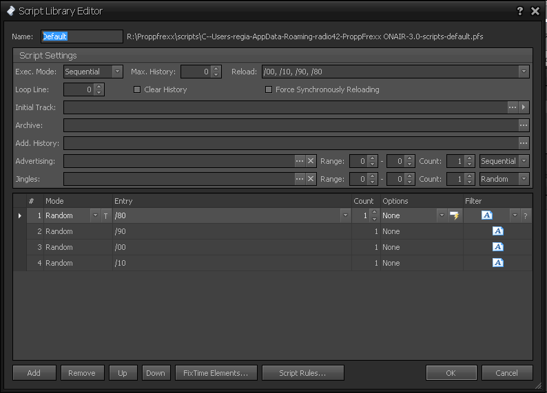

and this is my actual script revisited:
Cattura script.PNG (26.89 KiB) Viewed 12235 times

radio42 wrote:What do you mean by "more than one nas" - what is a nas?
As explained above:
You might use one dummy script like this:
Name = Dispatcher
Exec. Mode = Random
Lines:
1. Random, /80
2. Random, /90
And then use in your effective script above:
X. Execute, Dispatcher
Network Area Storage (NAS) :D
I have more than one nas with music so if i can select main "caetgory" and ppoa automaticaly search in all medialibrary who was part of that category will be fantastic.
so if in 90 i will have:
90
/90
/90-2 (2°nd nas)
80
/80
00
/00
/00-2 (2nd nas) ...
i can select in script only 90(main category) for all songs inside 90 and 90-2
Best Regard
Gabriele
Re: Some song not played
As explained above:
Name = Dispatcher
Exec. Mode = Random
Lines:
1. Random, /80
2. Random, /90
Ahh, now I see what you mean...
I'll take a look, if something like this can be implemented in a future release.
However, in the meantime you might create dispatcher scripts like explained above to achieve exactly the same!
Note, that since v3.0.12.00 you can now specify a media library category with the script-line mode Random and Cardwall.
See here for details: viewtopic.php?f=4&t=822
