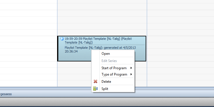

Re: Re-open playlists created by playlist template wizard
I upgraded, but, I only get the options mentioned in the attachement. Tried it several times, checked for the right version, I must be doing something wrong, but what....

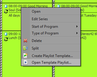

That is a bit strange?!
Did you actually select a scheduler entry?
It is directly located underneath the 'Create Playlist Template...' item, see here...
Yes, I did select a scheduler entry.... Tried it once again, but still not working. I just doesn't show the bottom two options.
These 2 menu items ONLY appear for 'future-dated' entries!
However, I'll take a look again, what might else be causing it in your case...
