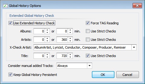

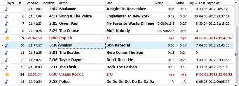

Please, see attached printscreens. I do not understand why I got items 6 and 15 when extended history check is set to relaxed so these two artists should not appear so close in playlist. How can I solve it? Are my settings correct?
- history check setting.jpg (48.28 KiB) Viewed 16764 times
- playlist after history check.jpg (117.24 KiB) Viewed 16764 times
Peter

No, a simple word match wouldn't work, e.g. think of "The Police" and "The Who" or "The Beatles"...if pure simple word match would be used, they would all be considered the same
Re: History check
Hm, but I still do not understand how does the logic behind crosscheck work then. What does PF compare with what exactly? Just take my case and please explain it to me bit detaily:
1. track is "Sting & The Police"
2. track is "Police"
What if first track is "Sting & Police" and second one "The Police", I suppose it will have the same result. Maybe I am blind but only "the" makes this difference? So for example "Cranberries" is different from "The Cranberries" and PF could play out two tracks from Cranberries if they are not completely equally named?
Thank you.
Thank you.
Peter
Re: History check
Exactly - the word "The" makes the difference in the Artist names and as such the Artists are NOT considered the same.
ProppFrexx doesn't 'know' anything about those 'filler' words of course.
As explained, the 'relaxed' check splits the Artist value by certain (standard and fixed) separators (like "feat", "pres", "meets", "vs", "with", "and", "&", ";", "/" etc.) and then compares each splitted value against each other.
As such "Sting & The Police" would match "The Police" but not "Police" ("Sting & The Police" would be splitted into "Sting" and "The Police")
or "Sting; Police" would match "Police" but not "The Police" ("Sting; Police" would be splitted into "Sting" and "Police").
This has nothing to do with the "X-Check Artist" feature.
The "X-Check Artist" feature does the same logical comparision of the Artist value with a list of defined other meta data fields (e.g. AlbumArtist, Composer, Producer etc.).
Example:
If e.g. your AlbumArtist field would contain "Sting; Police" for item 6 and "The Police" for item 15 it would find a match...
Item 6: Artist = "Sting & The Police" (splitted into "Sting", "The Police"); AlbumArtist = "Sting; Police" (splitted into "Sting", "Police")
Item 15: Artist = "Police" (splitted into "Police"); AlbumArtist = "The Police" (splitted into "The Police")
Now each splitted item is x-checked againest each others splitted item...and would match.
Or in short: ProppFrexx splittes the field values (as explained above) and compares them against each other. However, ProppFrexx can of course not eliminate/detect certain 'filler' words like "The", "A", "Mr." etc.
Example:

This is not a bug, but by design!
With the 'relaxed' check ProppFrexx tries to find similar Artist based on certain separation patterns, like 'feat.', 'with', 'and' etc.
However, in your case the relaxed check (for item 6 and 15) would compare the following:
Item 5: "sting" and "the police"
Item 15: "police"
...as such there is no match, as neither "sting" nor "the police" would match "police" - ProppFrexx would therefore still think that "The Police" is different than "Police" and consider them as two different Artists.
You might need to use the "X-Check Artist" feature (which you are already doing) - but that also means, that within one of those fields you much specify the same matching keyword, e.g. "Police".
Item 15: "police"
