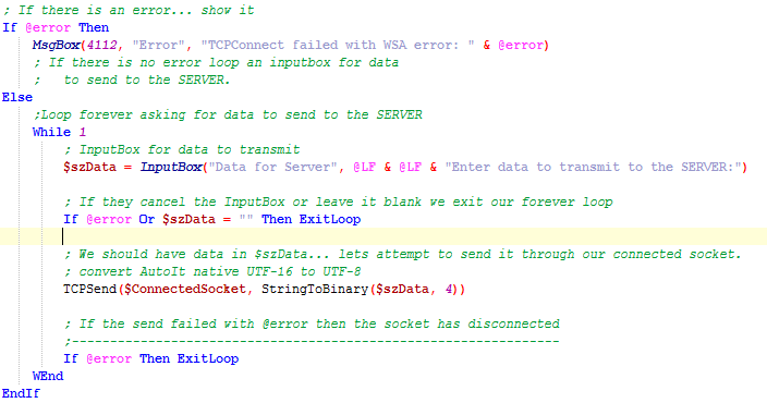

I'm trying to make the TCP messages work, in order to control proppfrexx with a small AutoIt program, but, it seems not to work properly.

Here is the autoit code.

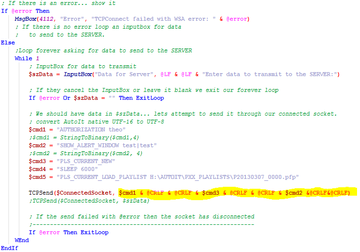

I tried those expressions
- "AUTHORIZATION mdp\r\nSHOW_ALERT_WINDOW test|test\r\n"
- "AUTHORIZATION mdp\r\n\r\nSHOW_ALERT_WINDOW test|test\r\n\r\n"
- "AUTHORIZATION mdp\r\rSHOW_ALERT_WINDOW test|test\r\r"
- "AUTHORIZATION mdp\n\nSHOW_ALERT_WINDOW test|test\n\n"
Nothing works. Have you got an idea what I'm doing wrong ?

I find my mistake
But there is still a problem : why will I not be able to chain the commands ?
In the exemple above, there are 3 commands, but the last doesn't execute.
If I try "AUTHORIZATION" + "SHOW_ALERT_WINDOW", it works fine. If I try "AUTHORIZATION" + "PLS_CURRENT_NEW", it works fine. If I try "AUTHORIZATION" + "PLS_CURRENT_NEW" + "SHOW_ALERT_WINDOW", it doesn't work : only the PLS_CURRENT_NEW is executed.
Moreover, my $cmd4 command doesn't work anymore (the path is correct !!)evenf if I try it alone with AUTHORIZATION...
Any idea ?
Theo, from France.
Re: TCP messages ?
The syntax is, that each command must be seperated by a CRLF (\r\n) and the final command gets an additional CRLF (ending with \r\n\r\n):
"Command1\r\nCommand2\r\nCommand3\r\n\r\n"
Example:
"AUTHORIZATION pwd\r\nSHOW_ALERT_WINDOW test1|test2\r\nPLS_CURRENT_NEW\r\nSLEEP 1000|PLS_CURRENT_LOAD_PLAYLIST H:\Autoit\P20130307_0000.pfp\r\n\r\n"
If all that is too complex, note, that there is also a command-lin tool available within the ProppFrexx installation folder called "pfremcmd.exe" which handles the communication for your.

Stuning.... It works as you said (for chaining commands, except that 2 CRLF seems to be needed for each commands...), but the "PLS_CURRENT_LOAD_PLAYLIST" command keeps not working... perhaps because of the "\" into the path of the playlist filename...
Never mind, I will use pfremcmd, but I would prefer that my own program would do the job... :-(
