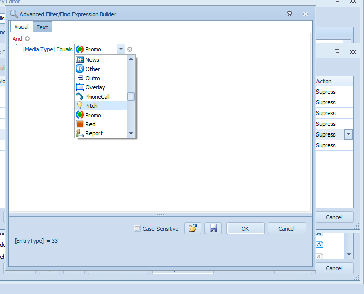

Isn't the Placeholder in the list of Media Entry Types?
If not I must have forgotten to add it to the selection list within the filter rules (so in case I nedd to add it, I'll double check this).
As a workaround you might also add a rule to check, if the Filename property is empty, as a Placeholder is an element which does't have any Filename.

Checked it, Placeholder is not in the list (see screenshot)
