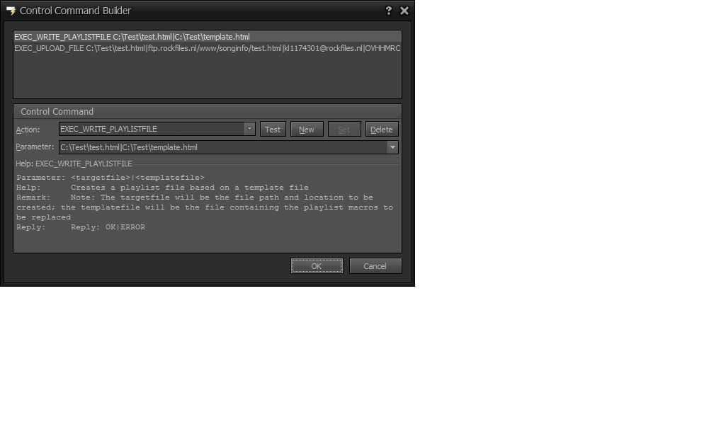

Thanks for your answer! What I actually need to know is where excactly in PF do I fill in these commands.. I know that it's needs to be doen in de event/command section. But what are my next actions then?
Maybe someone could help me out with this..
rockfiles.nl 110% rock radio!!
the no.1 rock & metal station!!
Re: Album cover on website
Thank you Bernd,
But when I'm there, what's my next action?
I put an attachment with this message, so you can see my current situation.
- command builder.jpg (68.65 KiB) Viewed 18315 times
Not sure what more you are looking for.
When you placed those two commands e.g. with the "Streaming.OnSongTitleChanged" event and they are working fine...then you might have a file called 'test.html' on your web-site?
Is that working?
If not, what happens, if you open the file C:\Test\test.html locally within your internet browser?
