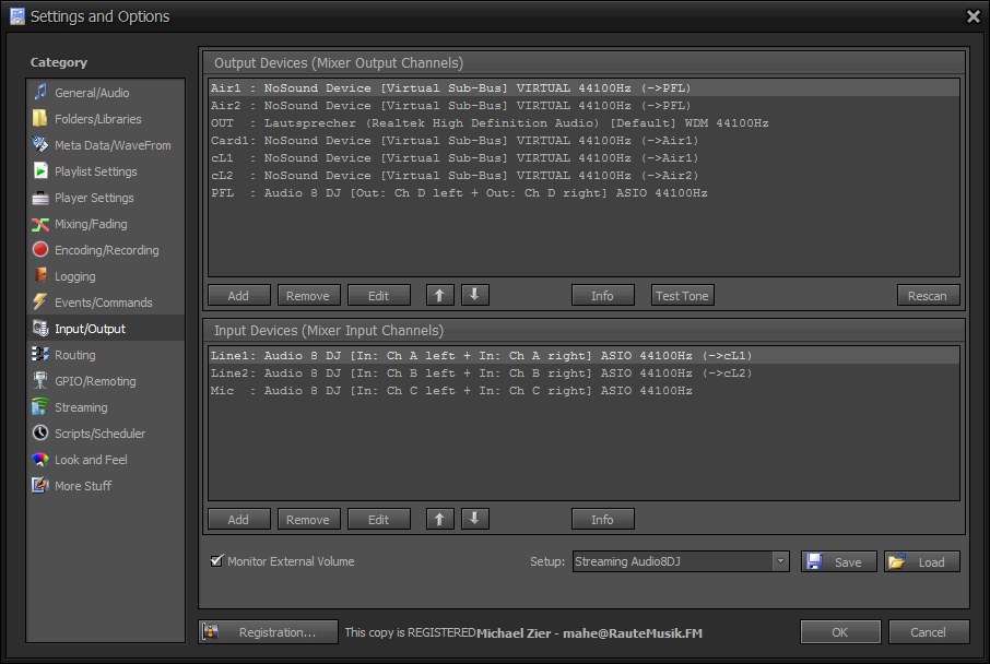

I've attached a screenshot of how I configured the input/output

I can't set the OUT-channel to ASIO, the ASIO driver I use is only for the Audio 8.
Here the screenshots of the settings you asked for:
I don't need the OUT-channel, what I'm streaming is the AIR-Channel (Air1).

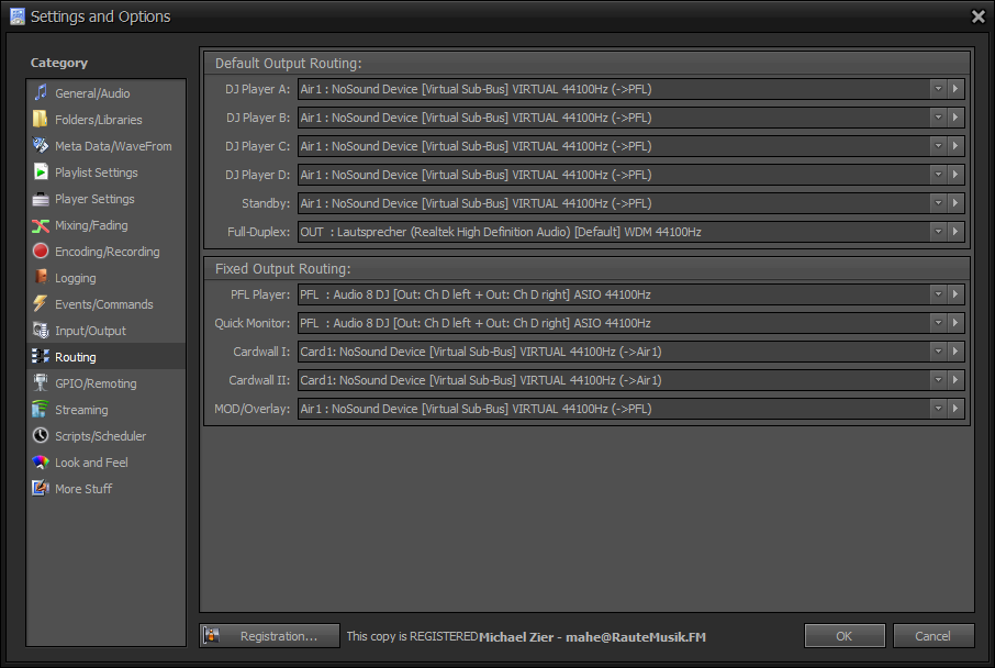

The setup looks okay so far.
What are your routing settings resp. the SND settings for the different mixer-channels.
The only issue I might see (which might be causing issues is the OUT mixer-channel), if thats in use somewhere (e.g. via SND).
As here you are 'mixing' ASIO and WDM.
What would happen, if you are also using ASIO for this channel?

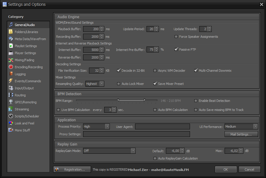

And what are your WDM buffer settings (general settings, section Audio: Playback Buffer and Update Period).
Re: Settings for Native Instruments Audio 8 DJ? Got some pro
As far as I can see does the Audio 8 have 4 stereo inputs and 4 stereao outputs - so why don't you have another ASIO output available, you are so far only usin one?
The issue might be, that when mixing two different soundcards, their sample rate might not be perfectly running at the same clock speed, as such the one gets its buffer either overrun or underrun.

I just routed the Full-Duplex to the internal soundcard because I don't really need it xD
I'll try what you said.
