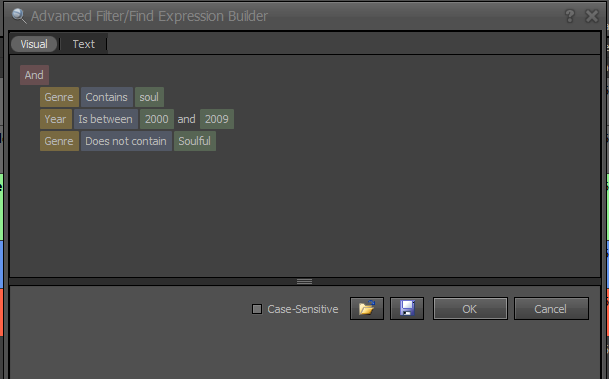

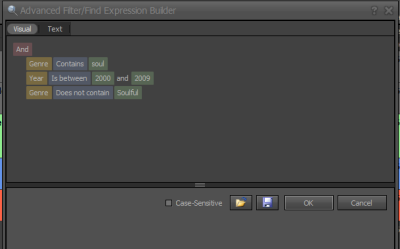

I am trying to filter my tracks by genre and year. In the example shown I am getting expected results but wanted to also find (add) tracks with the genre rnb for the same period 2000-2009. Do I have to run this as two seperate queries or is there a way to run this as one filter/find expression. Every permutation I have tried hasnt worked including add as a 'group' (i'm not exactly sure how that works).
PS. I also need to exclude any genres that include Soulful (e.g. soulful house) hence that condition.

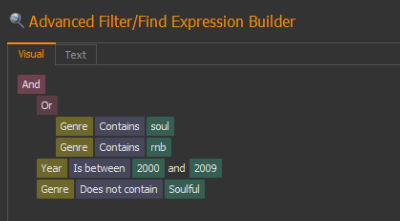

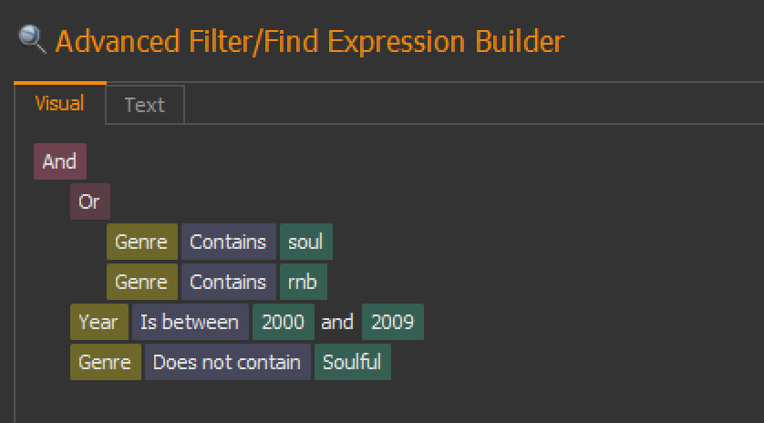

Is this what you want?
Note, that you can also use the 'Text' view to simply add logical brackets (which defines a group).
In this example, the 'Genre' can contain either 'soul' OR 'rnb'; plus (and) the 'Year' must be between 2000 and 2009; and the 'Genre' should not contain 'soulful'...
Text:
(Contains([Genre], 'soul') Or Contains([Genre], 'rnb')) And [Year] Between('2000', '2009') And Not Contains([Genre], 'Soulful')
