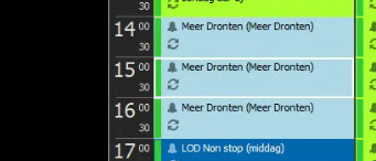

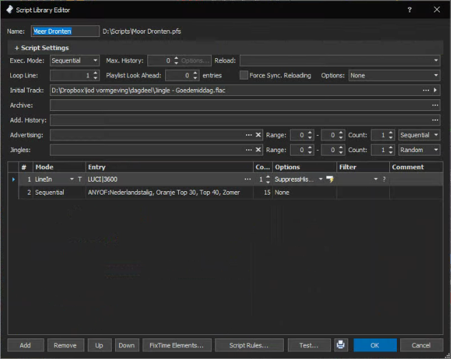

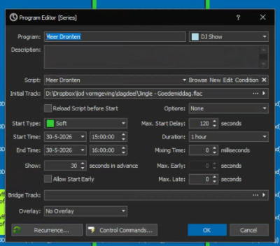

Bellow some screenshots of the scheduler, Program Editor and Script.
To me it looks good.
