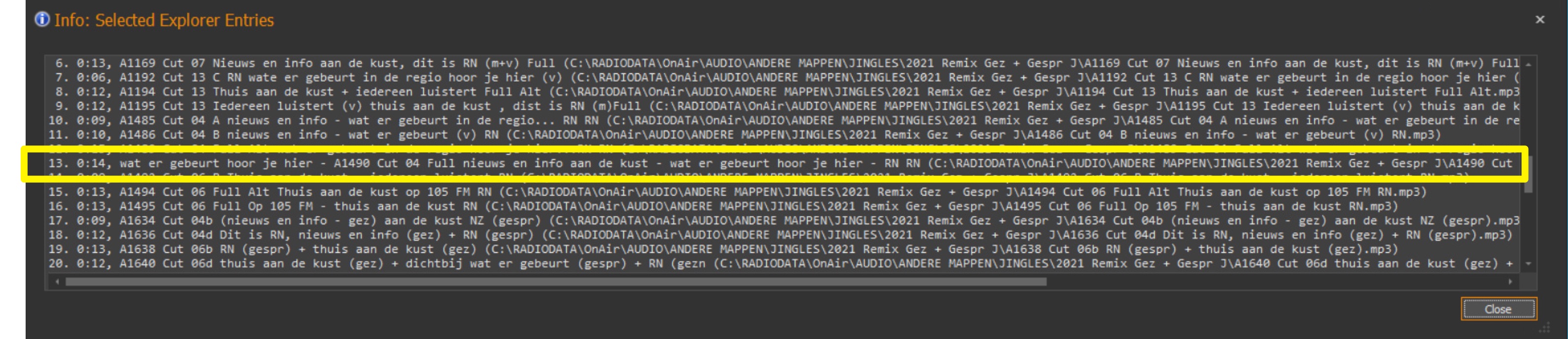

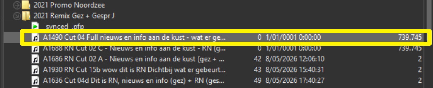

We were looking for the reason why a certain jingle wasn't played. We saw in de explorer that the age last played is 739.745.
The file plays without a problem via the PFL Player.
We checked the _synced_.pfp file in that directory and the audiofile is correctly added to the file.

However, when we display the info in the explorer for this _synced_.pfp file we see different information (as if there was "wat er gebeurt hoor je hier" in the artist metadata in the file.
In the entrystat we also see "wat er gebeurt hoor je hier" added

The problem is that in the explorer the jingle has no age last played. So it gives the impression that the jingle is not played.
Our program director mainly uses the explorer to check if everything is correctly played.

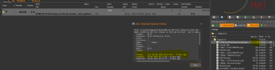

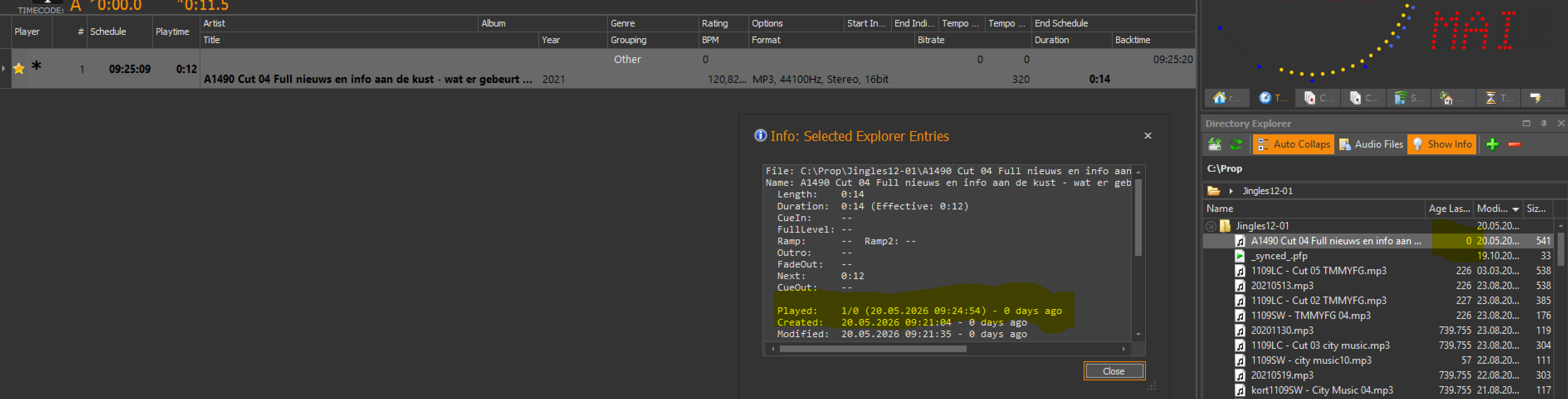

I just tested your file and a related folder based media resp. cartwall lib.
However, I can not reproduce your issue. I played the Jingle and it showed the right age (0 days).
So please try to Rescan the library and make sure you do't use any any .pfmd files to avoid inconsistant meta data.
