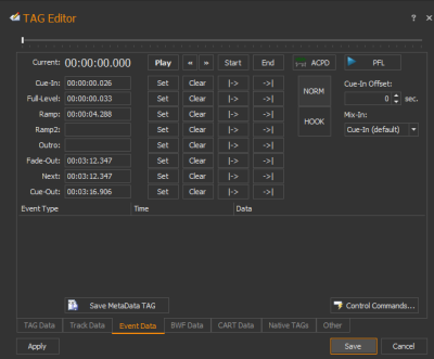

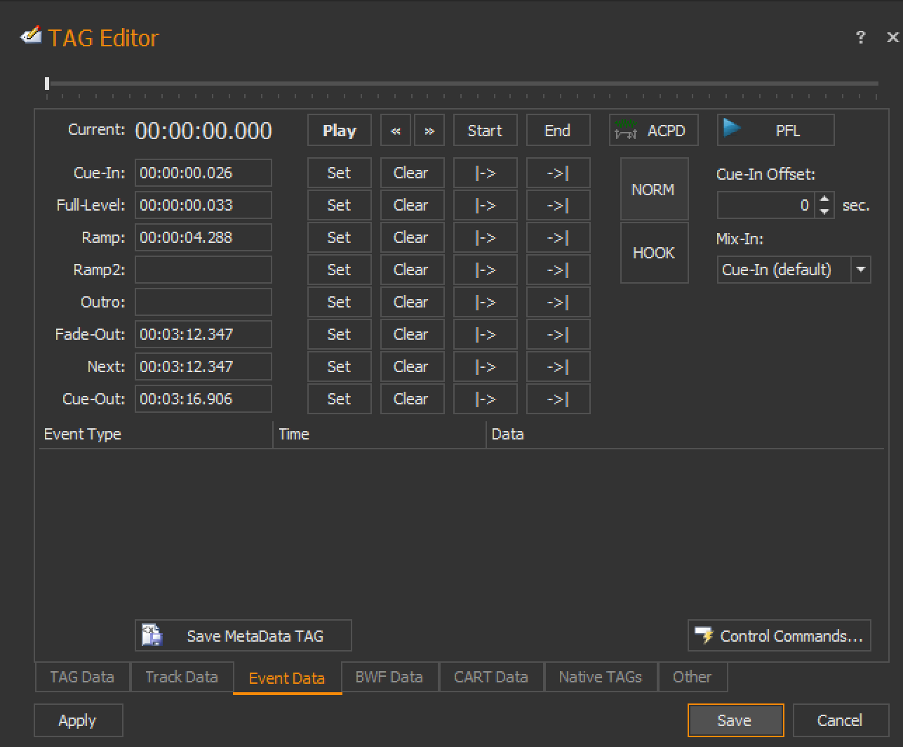

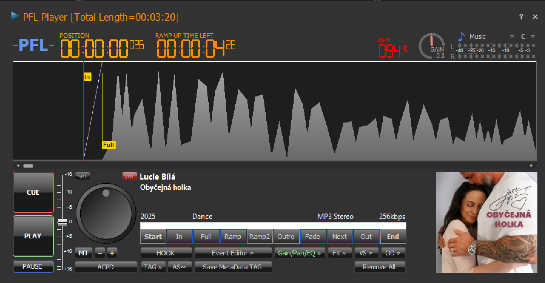

And here are also some pictures, which show, that the Cue-In position is correctly set a few millisoconds before the Full-Level and the track is ramped in between.
Maybe you can also send a video to demonstrate your issue?

It's doing the exact same thing to you as it is to me. The playback from CUE-IN is slightly clipped (or 'cut off'), while from FULL it plays normally. It's been behaving this way since the second-to-last update. Before that, there was no loss (or 'clipping'). It only does this when the difference between CUE-IN and FULL is this short. Otherwise, it doesn't happen. But I use this setting so that the beats at the start of the track aren't shortened (or 'cut off').

As said, the level is ramped between CueIn and FullLevel.
Ie. When both cue-points are present, the volume at CueIn is silent and then faded to FullLevel.
Ie. it works exactly as designed.
