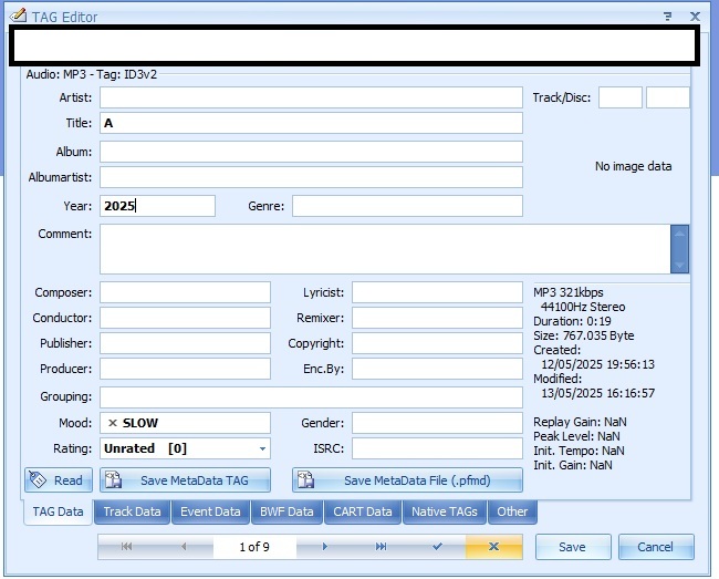

Is there a possibility to tag multiple files at once in time?
Now this can be done 1 by 1 but can this also be done for a complete folder?

and can you also place all the years of 20 files in 1 click on 2025? Or do you have to click on each file with the V?

Post by Jeroen R »
I do this in tagger, not in PF on air.
So select all files with ctrl+a and then edit tags.
But here I can't change all of them at once. I'm still doing something wrong but I can't find this....

Post by Jeroen R »
For each file I have to click on V at the bottom... but not everything goes at once, for example to 2025.
Re: TAG on TIME
See above! What I explained under b)
In the Tagger you don’t even have to enter direct Tag Editing mode - this is on by default!
So just click into a cell to enter a new value. Press enter to confirm and save it.
Mark/Select multiple rows and then edit a cell value to edit all values of the selected/marked rows (except the song title value) at once.
In the Tagger you don’t need to invoke the tag editor- you can directly edit the table values.
Show more columns to be able to edit almost any any tag value.
