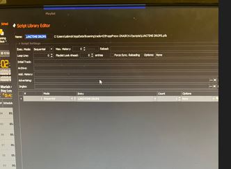

I've developed a sequential script and am using an overlay to trigger it, but I'm facing two issues:
1. The overlay requires the script to be longer than 10 seconds. So often skips and will not play.
2. When I run the overlay manually, it completely mutes the music instead of just lowering the volume.

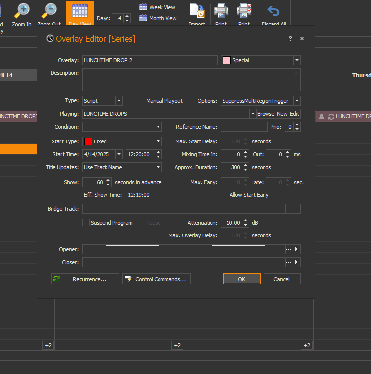

I've attached the overlay settings.
I've tried different attenuation settings but all result in muting the music to low.
I want the overlay to play while lowering the music slightly.
I've tried attenuating to -90 and -10
Am I attenuating incorrectly.

I unfortunately can not reproduce your issue. Here are two examples with -3 dB resp. -10 dB attenuation:
https://www.dropbox.com/scl/fi/zhqzjyje ... 5xeim&dl=0
https://www.dropbox.com/scl/fi/t4hrmfig ... h159f&dl=0
You can clearly here that the underlying playlist continues to play and is attenuated.
But depending on your 'sweeper' you might not notice this. In the above example, that sweeper is quite loud and compressed, so it overrules the normally leveled audio.
Here is an other example, with -5 dB attenuation but a 'softer' leveled overlay:
https://www.dropbox.com/scl/fi/0f8jm4q4 ... tn5h0&dl=0
Note, that a -6 dB attenuation means, that the volume is lowered by 50%. An attenuation of -20 dB means 1/10 of its amplitude (or 1/100 of its energy).
So make an example yourself: play the overlay with 0, -1dB, -2dB, -3dB ... attenuation. Use at best a text spoken audio example to hear the music attenuating...

Can I confirm you are adjusting your attenuation in the overlay schedule where it says attenuation ?
Re: Playing artist drops over music
How do you test your overlay?
I can not see the overlay player in the video nor your mixer channels… so where does the overlay play?
And yes, in my test I only change the attenuation value of the overlay entry. I let the overlay play via the scheduler in the overlay player.
And no, there is no other general setting. Please try again with -1dB attenuation value.

I have attached screenshots of the media library container with the drops, the script config, and the overlay with Attenuation set at -1.00 db
