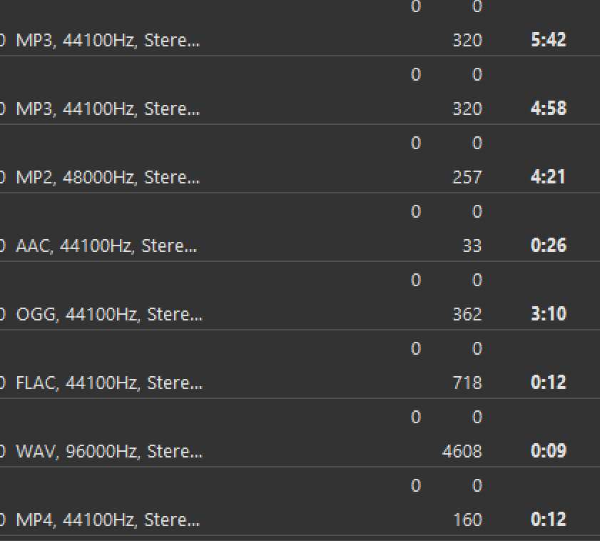

In addition, PF also doesn't show the format of the files (in playlist). It shows: 'Unknown, 0,. Even with files which used to work. Maybe with one of the last updates something went wrong?
Re: Proppfrexx loses metatags
Please send one file you have issues with (the audio file as well as the related .pfmd file)!

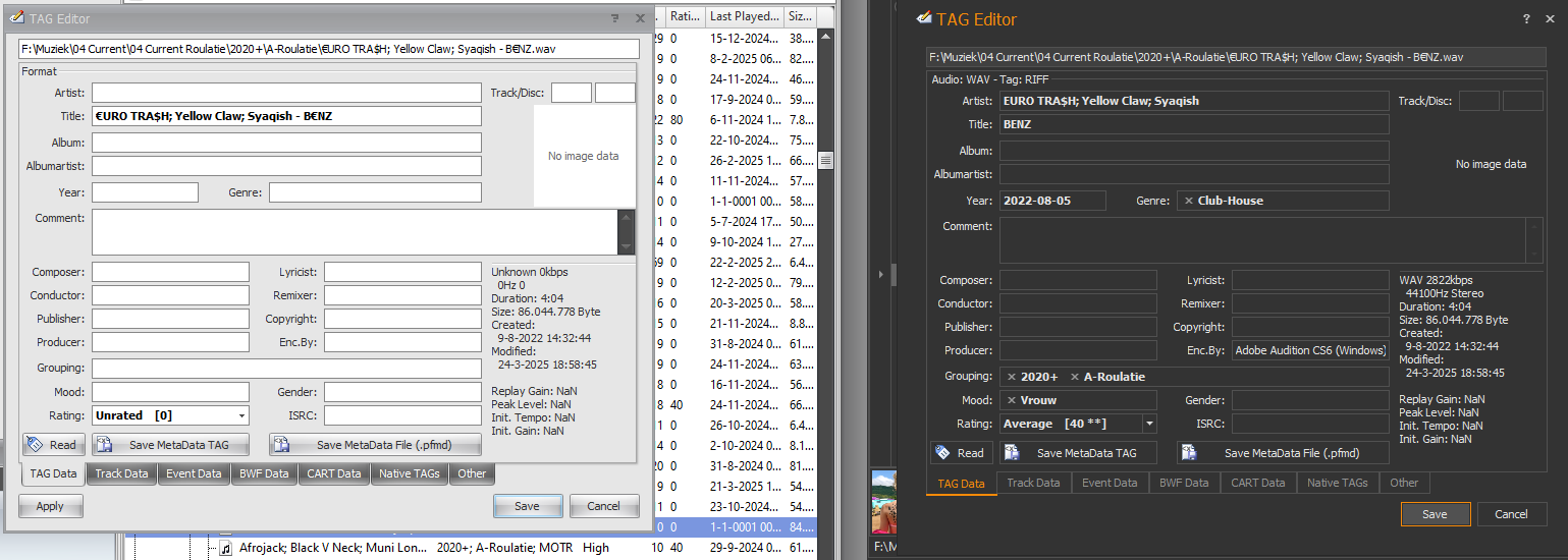

On the left ONAIR, on the right Tagger. Both show different info from the same file.
I can also not reproduce your File Format issue in the latest version, see here:
So also send a file where this happens to you.
