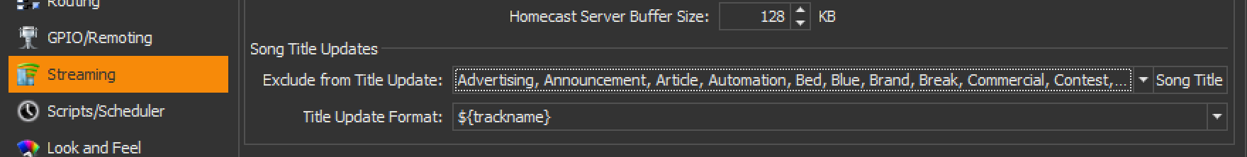

When you use the "Streaming.OnSongTitleUpdate' event, you only need to configure the Exclude filter in the general settings section under Streaming.
Here is my demo and test setup, which works perfectly fine as you can see:

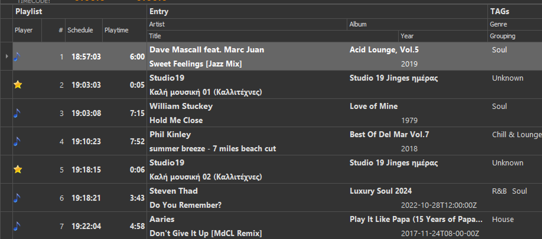

1) The playlist:
Note the 2 entries in it of type Jinlge - these should be suppressed:

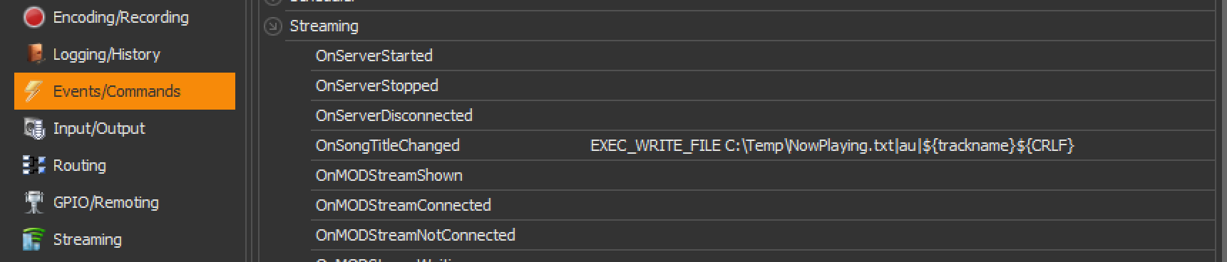

2) Sections Events/Commands, Event: Streaming.OnSongTitleUpdate - here is the NowPlayling.txt written:

3) Section Streaming, Exclude from Title Updates - here you exclude all media types (except Music):

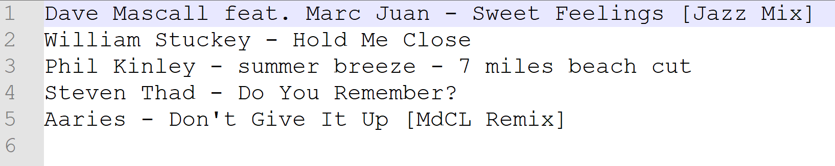

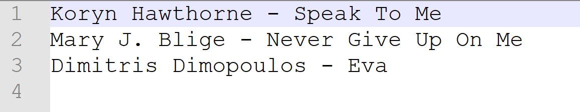

4) When you let this playlist run/play - the following NowPlayling.txt is written:
As you can see the Jingles are NOT included - i.e. the Exclude Filter works as designed.

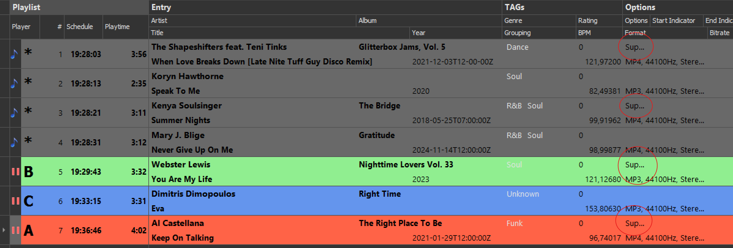

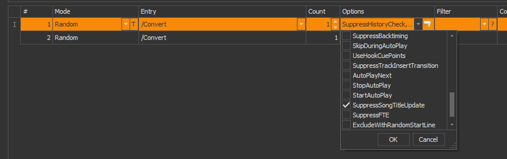

Next Test with the Script - SuppressSongTitleUpdate option set:
The generated playlist using that script (not the Option being set - circled):

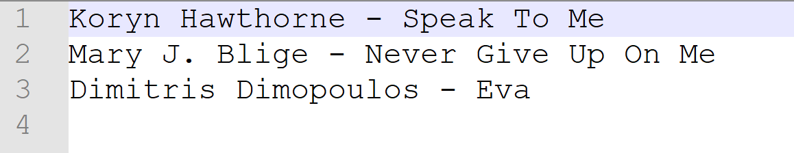

And again the NowPlayling.txt file - containing only every 2nd entry as expected:
I hope this clarifies your issues and shows you, that all is working.
If you only want to write one track at a time to the NowPlayling.txt file, you might change the command to:
C:\Temp\NowPlaying.txt|nu|${trackname}${CRLF}
Maybe you are writing the file with a different event?
