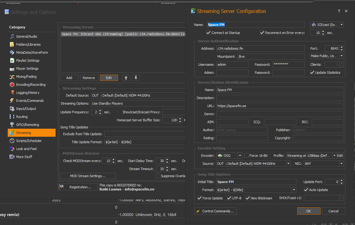

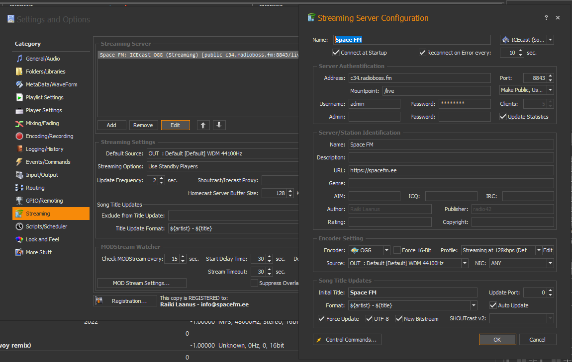

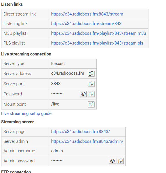

When I add my own server data (the server is in the Radioboss cloud) the program doesn't even show if the connection failed or something is wrong. The log is also empty and doesn't say that I tried anything at all. Please help!!

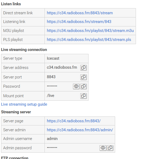

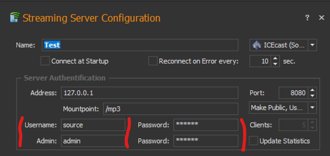

As already said, make sure, that in the streaming server configuration dialog all values including the address and credentials (username and password) are okay. From your screenshot they don't look okay (you use admin where the source should be used).
NOTE:
The Source username is by default 'source' - where you have specified 'admin' and the source password is typically different from the Admin one.
Make sure you have specified the correct username and password for Source!

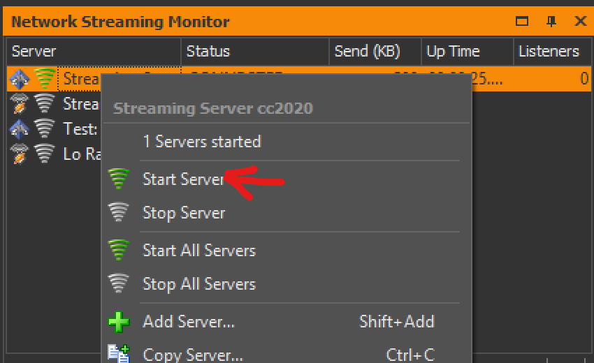

In the streaming monitor window, right-click on the entry and select 'Start...'
Then make sure, it shows 'CONNECTED' after the entry.

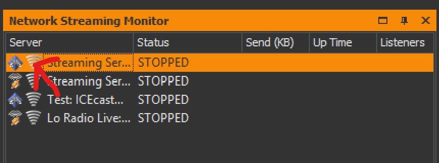

Else make a click on the stream icon (2nd one, which should be green if connected) for that entry to show the last error message (if any).
