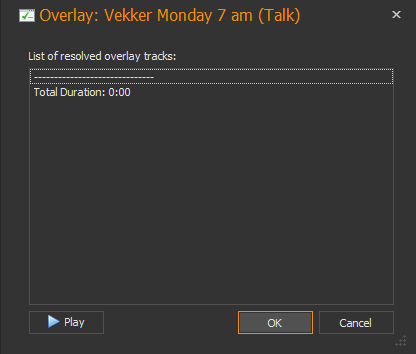

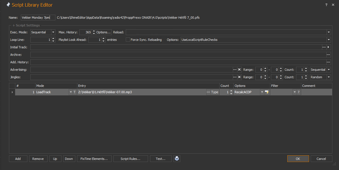

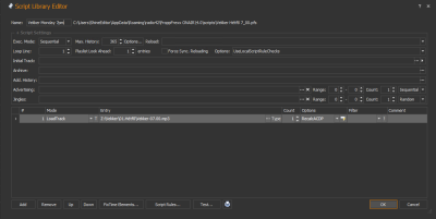

I wrote the script, I only selected 'Load Track', I selected the "RecalcACPD" section in the settings.
However, when calling the script, the value duration time: 0 and the overlay does not want to start.

Re: Overlay Scheduler LoadTrack Question
You should not set any script history in that script AND also add (leave) the option to suppress any history checks!
Use the 'Test...' function with the script to see what is going wrong!

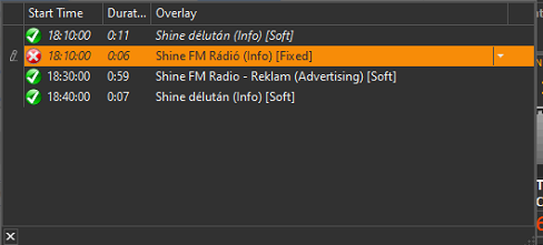

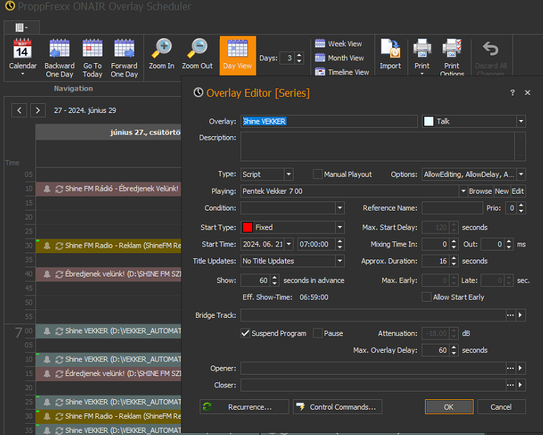

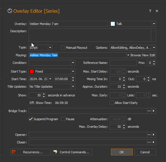

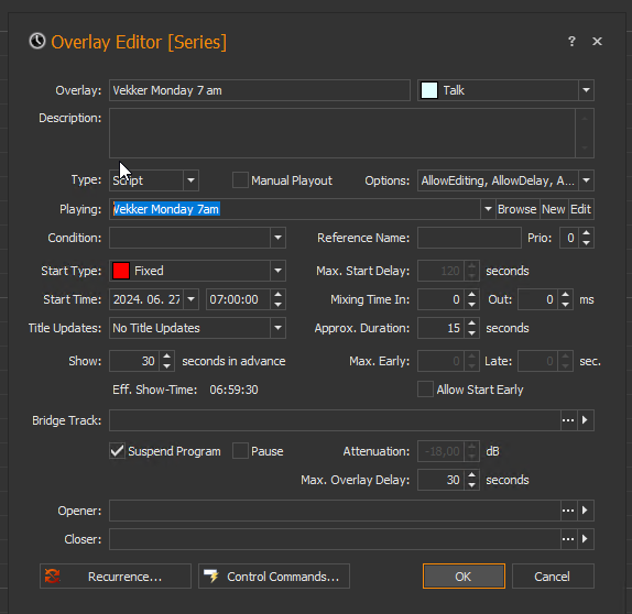

Now the script call is perfect, but I can't do it well in the overlay editor, because it doesn't start the container at the specified time, but skips and goes to the next track.
What could be the cause of the error?
I tried to generate tomorrow morning's broadcast and I can hear that the advertising and program signal containers are working perfectly, but the program in my question, is left out and just moves on.
Many Thanks.
Tibi
The Overlay Scheduler Log (see Tool tab - Log Files) will tell you…
Looks like you have another Overlay starting statue exact same time. Did you select the Combine Parallel Overlays? And set a Prio. to define which overlay to play first?

After fine-tuning, things are going well. Thanks for the help!
Unfortunately, the Title Updates section is still not good for some reason. Even if I set it up as described, it sends it to the stream for this length:
"Overlay: Shine VEKKER [1 Entries] - Shine VEKKER"
All you need to say is: "Shine VEKKER"...
The broadcast goes out through an external BUTT program
On Proppfrexx settings/Commads/ON TRACK PLAY: EXEC_WRITE_FILE D:\REKLÁM\nowplaying.txt|nu|${artist} - ${title}.
What could be wrong here?
Thank you again.
But then nothing is wrong on the ProppFrexx side.
When you write to the external encoder ${artist} - ${title} this is exectly what it receives.
I understand that this is not what you desire, but this is exactly the artist and title of an overlay container.
The title update settings obviously only work for the internal encoder.
So why don’t you use these?
Or tell the encoder something different for overlays?
