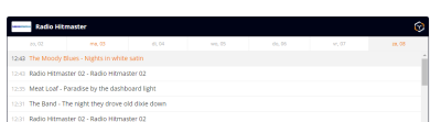

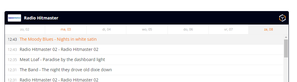

I meen this, i want there no jingles showing on the playlist of site.
See picture.
See picture.
Re: jingles remove on playlist
See general settings, section Streaming and check the media types you wish to exclude from any title updates, e.g. Jingles.
Use the MediaType to excluded Tracks - i.e. make sure they are tagged correctly - Exclude from Title Update:
Select all the media types for which streaming title updates should NOT be executed.
Note: For excluded media types the initial streaming song title (as defined per streaming server) is used and if this is empty no title update is performed.
Click on the 'Song Title' button to define individual song titles per media type in case you selected the 'Use MediaType for excluded Tracks' in the above streaming options.
