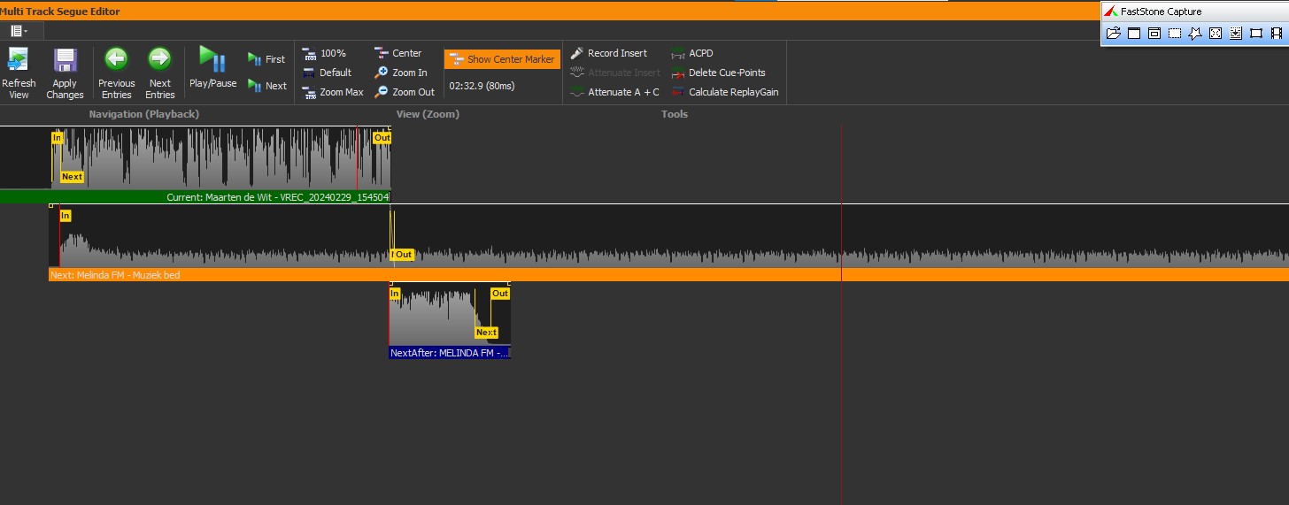

Multi track Segue Editor no longer works and it no longer saves its settings. Even the voice tracking. both in version 4.4.4.0 and 4.4.4.1

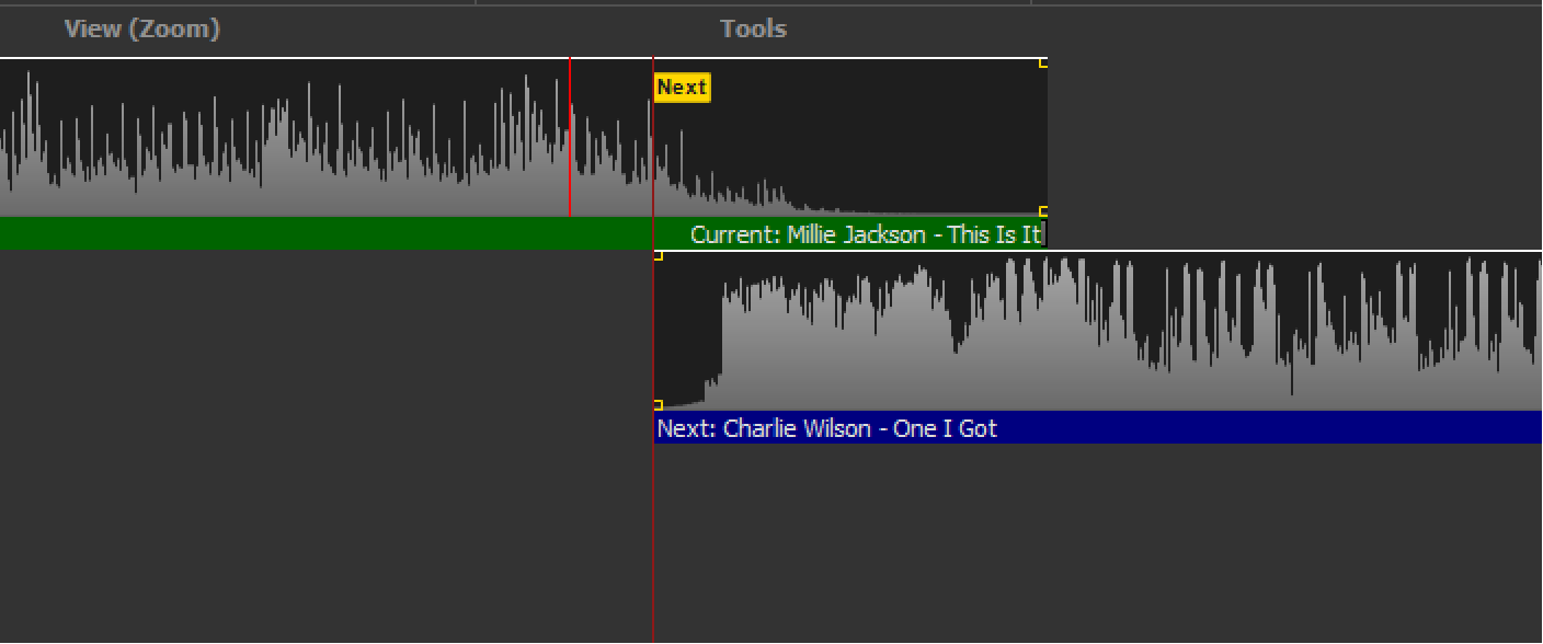

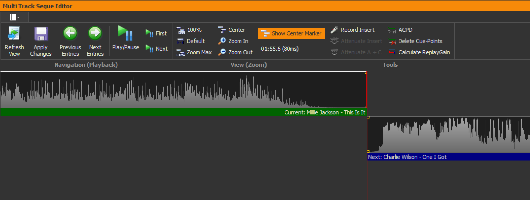

I started with two tracks having absolutely NO cue-points:
Then I just moved the track (which adjusted the Next cue-point) closed the Segue-Editor and then re-opened it:
So either you excluded to save the Cue-Points from the Segue-Editor; or the data can for whatever other reason not be saved - which would be very strange and probably due to so other settings/environments?

With voice tracking, the cue points of the next song are not stored properly

I think I know what's going wrong. We use "Automatic Playlist Template (Pre)Generation. All playlist created by Automatic playlist pregeneration, the cue in the voice traking is stored incorrectly in the studio. If someone creates a playlist that was not created before. Everything is OK.

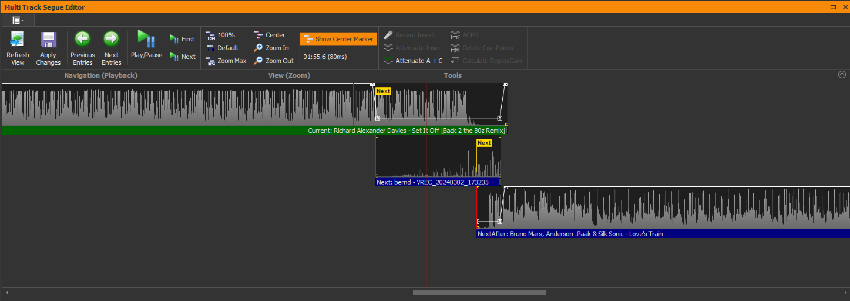

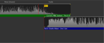

Thanks for sending it over. But also with your playlist and files I can NOT reproduce the issue. I used tracks 25, 26, 27...
I have opened the playlist, edited a segue, applied the changes, refreshed the view... closed the segue editor and re-opened it.
Even saved and closed the playlist and reopened it...
Ever time the changed have been there and I did not face the issues shown in your video.

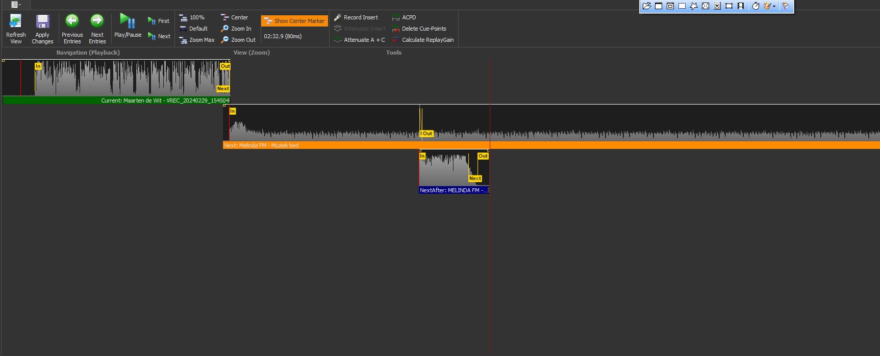

Before:
After:
So I am absolutely unable to reproduce your problem.

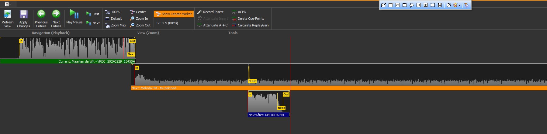

Post by atlantic »

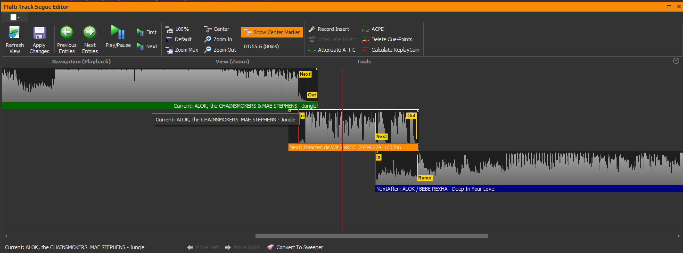

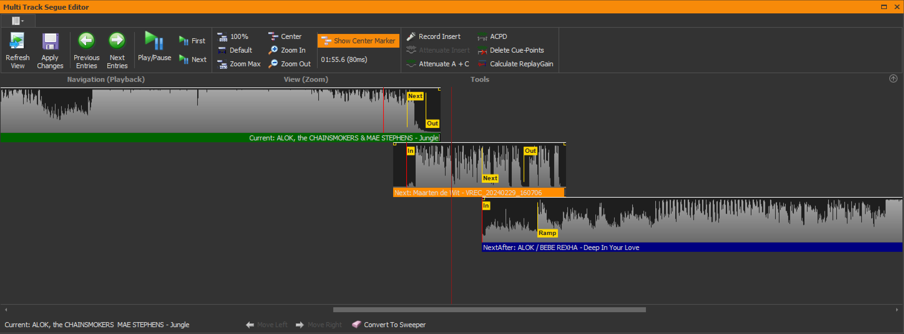

Bernd,
Can you try lines 6 and 7?
It will not be adjusted after saving and refreshing.
The MetaData/Tag Writing are also set as suggested.
I have some info for you DJs who have not updated (less than 4.4.4.0) do not have this problem. 4.4.4.0 is already installed in the studio. The (Pre)Generation is also correct with version 4.4.4.0
