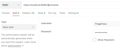

And yes, it uses Basic Auth with the username ‚ProppFrexx‘ and the password specified in the GPIO client. Ie. the auth must contain "Basic ProppFrexx:password" - whereas ProppFrexx:password needs to be base64 encoded.
Any commands needs to be send to the sub-address /commands, eg. to the address: http://localhost:8080/commands

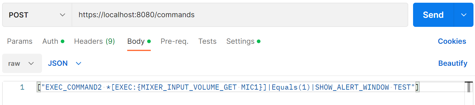

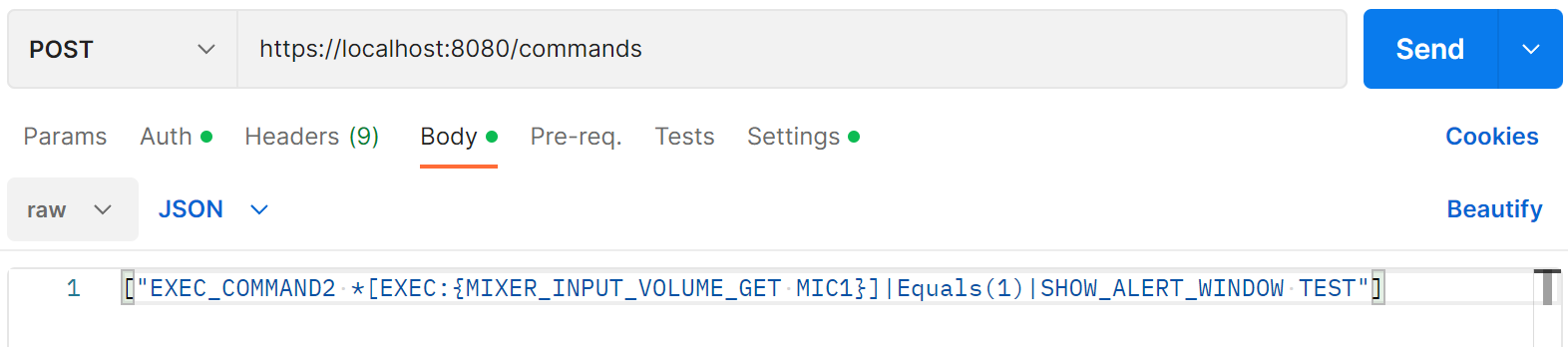

Error 400 however indicates, that your request has no body!
Ie. the body of the request must contain the control-command you POST to ProppFrexx. You can send the command eg. in text/plain. Ie. the command is NOT send as URL params, but as the body of the request.
Here are two sample screenshots using Postman:
