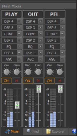

Instead of OUT1, we already wrote all the names of the output devices that are in the settings.

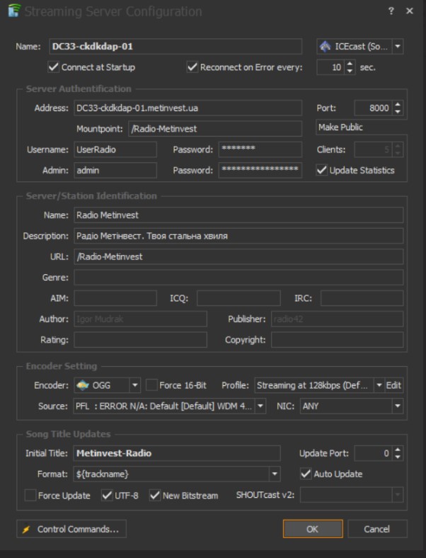

Music plays on a virtual server in streaming mode to a web server. May be this type of playback we should specify another "output device"?
we have RFL activated
on the mixer, the sound jumps on all "devices"
Re: Automatic air alert
On the screenshot your output mixer is called OUT and not OUT1. But in the command example you use OUT1.

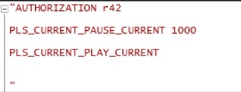

We put
1Знімок екрана 2023-04-11 160429.jpg (11.24 KiB) Viewed 7200 times

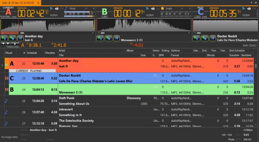

and it just switches between A to B track
may be we have some problem with playlist?

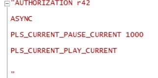

3Знімок екрана 2023-04-11 160736.jpg (9.1 KiB) Viewed 7200 times
with command ASYNC at the beginning and nothing is happening.
then we are running the script as you told without ASYNC
it just changes the track but if we run
everything plays OK
The problem is that nothing happens at all with ASYNC, and if without it, then just the tracks changes, the file with alert does not play at all :(
No quotes (“) at all.
No empty lines.
When using internally commands with events, the AUTHORIZATION line is not needed and not supported.
The ASYNC command must be the first line.
