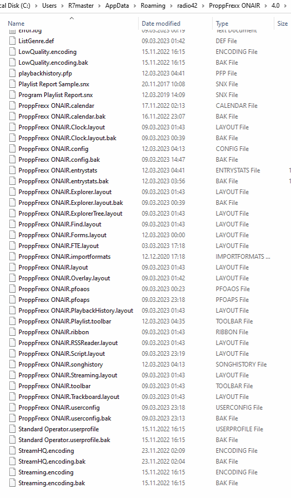

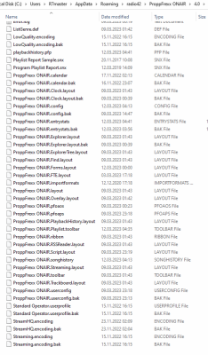

Yes, I also referred to this same post in my original post, that I got the knowledge from there that I could somehow process ML directly, but I don't have the files You described in my system
Re: Media Librart Config file
If they are not present in your ProppFrexx AppUserData folder (as it looks like) and you are not using the -config or -globalconfig command-line option when starting ProppFrexx, these files must have been deleted.
As ProppFrexx never deletes any of such files, I can only assume, that someone else must have deleted these files.
marvex
Posts: 44
Joined: 10 Nov 2022 12:13
Post by marvex »
We using -globalconfig command line, I don't remember Why - but we using
And now I find location where is my system Libraries file - thanks again
