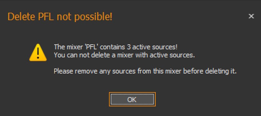

If you get such an error:
This means, that you still use that mixer channel in ProppFrexx.

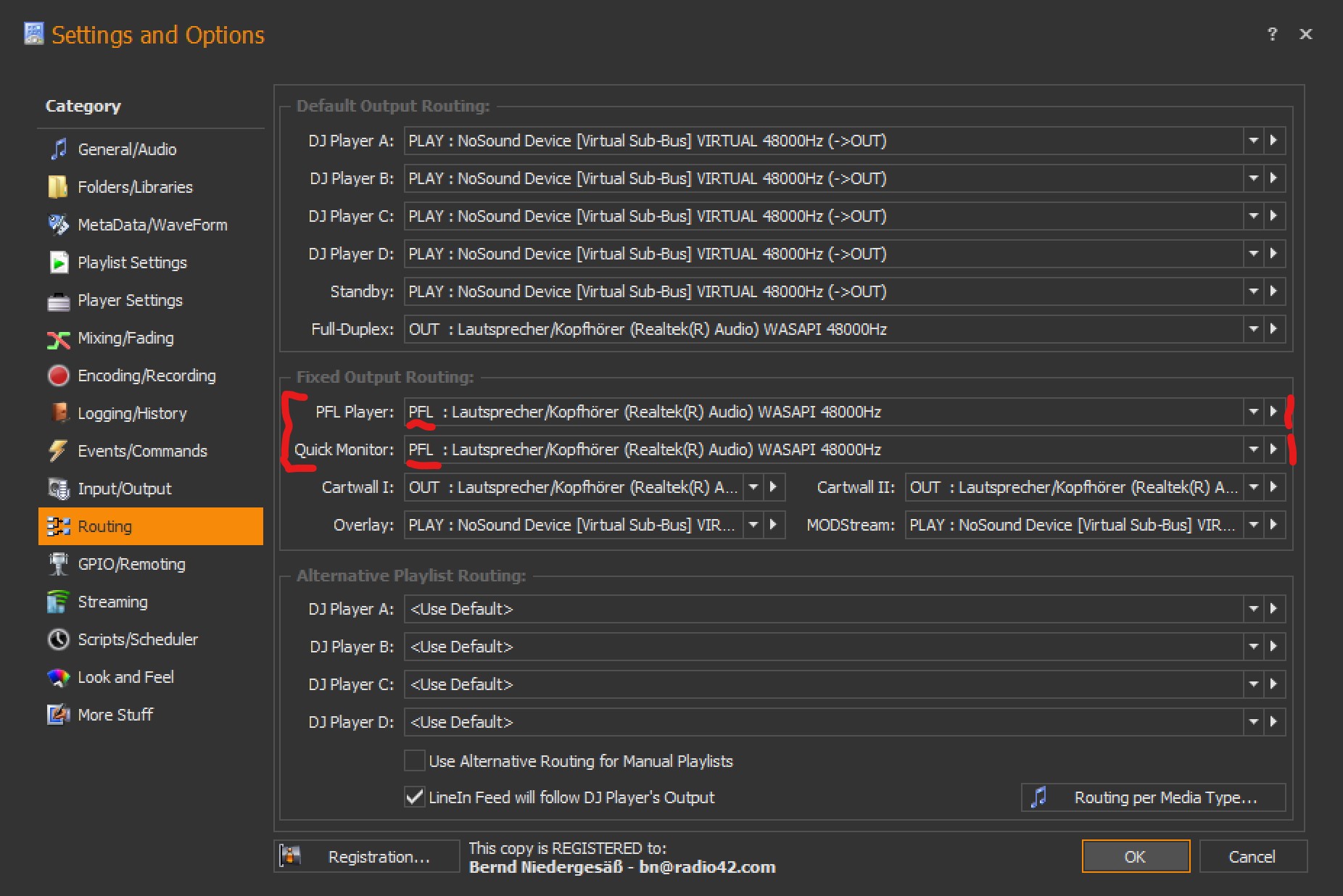

Thus, you need to first remove all sources from a mixer channel before you can remove it. Ie. if you still have routed the PFL Player or the Quick Player to the output mixer channel called PFL, you can’t remove that PFL mixer channel. So go to the general settings, section Routing and make sure, that nothing is routed to the PFL mixer channel (ie. route those to another mixer channel) before you can remove that PFL mixer channel.
