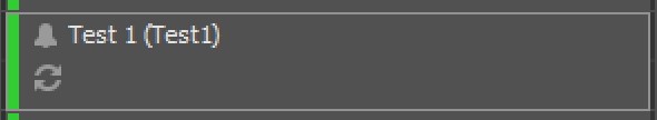

As such, if you want to do a local Voice-Tracking, you do this from the Program Scheduler entry, i.e. you do a right-click and select 'Open Playlist Template...'.

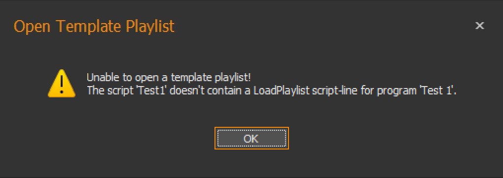

At this point you actually and visually see, if an import from an external log already happened or not. In addition your default script entry (for all so far not imported log file program entries) might not even contain a 'LoadPlaylist' script-line. In which case you even get an error when you select 'Open Playlist Template...'.
