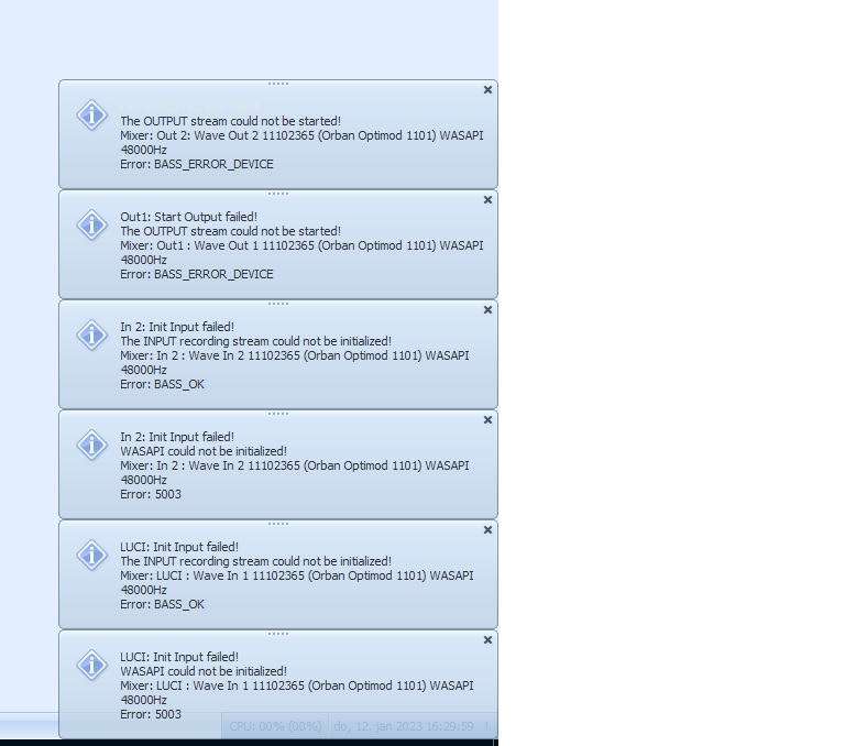

When i use the WASAPI i get the following error:
WASAPI could not be initialized!
Error: Bass_OK
Init input Failed!
Wasapi could not be initilized
Mixer: in 1: Wave in 1 (orban optimod 1101) Wasapi
error 5003
i am not sure what is happening..

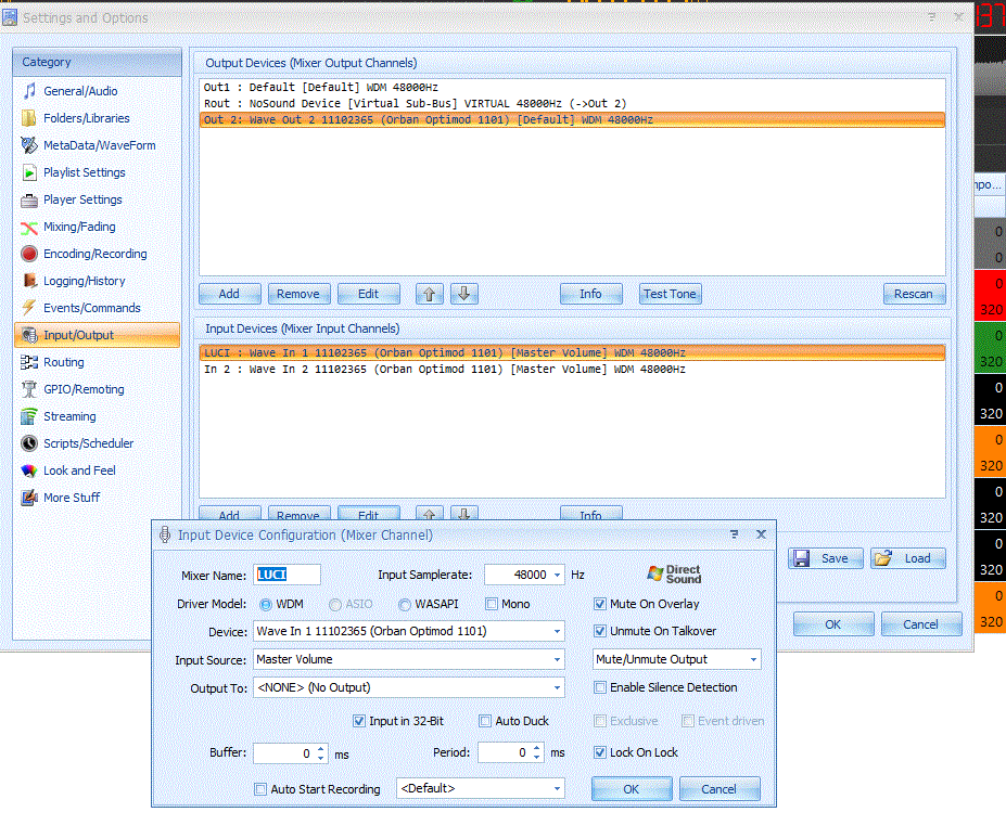

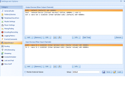

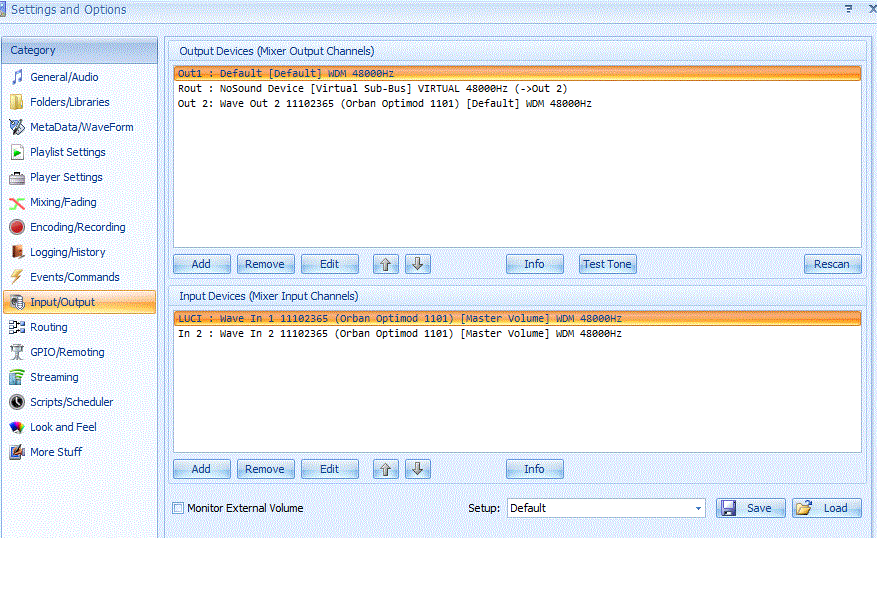

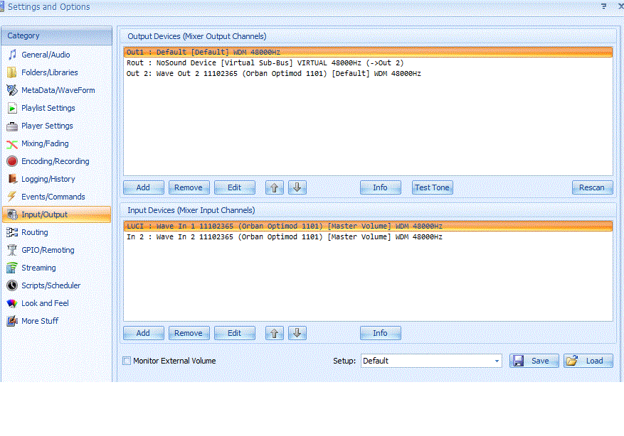

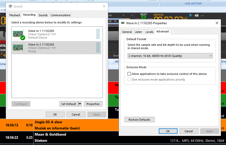

ImageHi Bernd,
thanks for you rreply.
I have checked over and over but nope. I even re-install the drivers and all seems to be okay.
The issue is only on input to route back the processed signal from the orban 2 the streaming encoder.
as requested herewith the images of the settings
Re: Bass error handle
Please try the WASAPI driver model instead of WDM.
And do this for ALL output and input mixer channels.
After you changed all. Please close and restart ProppFrexx.

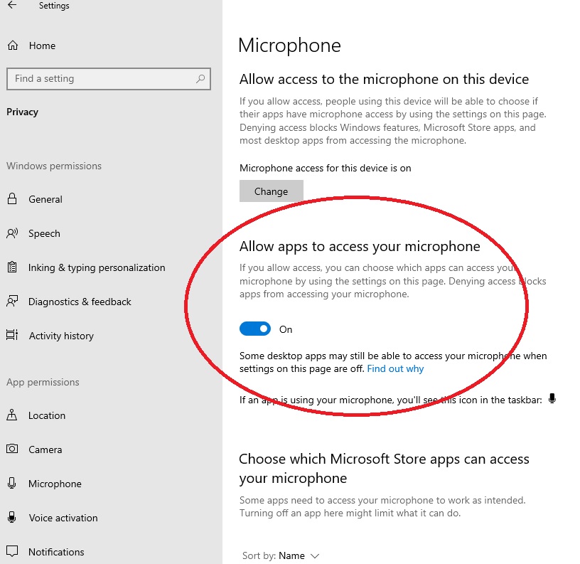

meanwile i have tried several other things and guess what, i had a "last hope' for 1 option..
In general the line in (mic) is switched on, but....
In the newer versions of Microsoft OS you have to grant MIC acces to apps (a privacy thing)... So, dont folow only the message: Microphone access for this device is turned on
The solution is to set the "switch" on for acces the apps as well.. this fixs the issue for the Line in
So this means that the issue is solved and can be closed.
