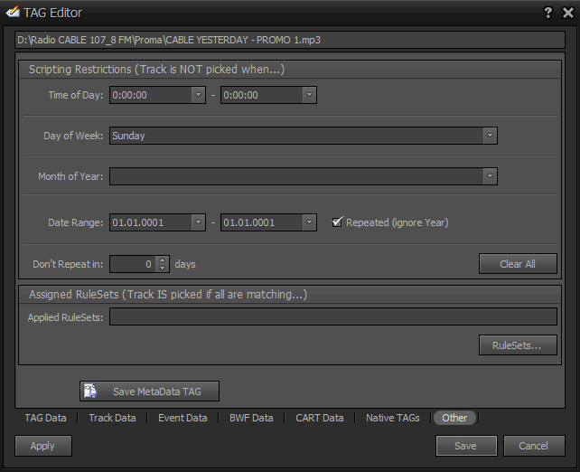

I have this setup. It always worked and suddenly the tracks are not scheduled. But I think that the Time Of Day and Date Range fields were not filled in earlier. It adds itself.

No, once you entered a Track Restriction, the Time of Day (even if you did not set is explicitly) is set to 00:00:00 - 00:00:00.
The same is true for the Date Range, which is set to 01.01.0001 as its default value.
However, the time range as well as the date range is not checked, when set to its default value.

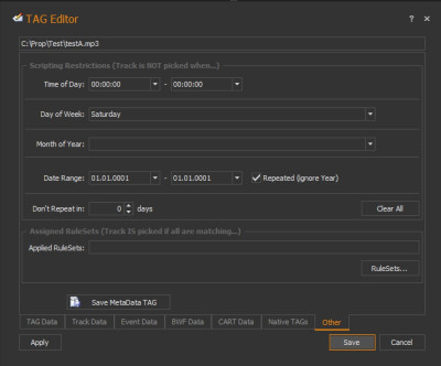

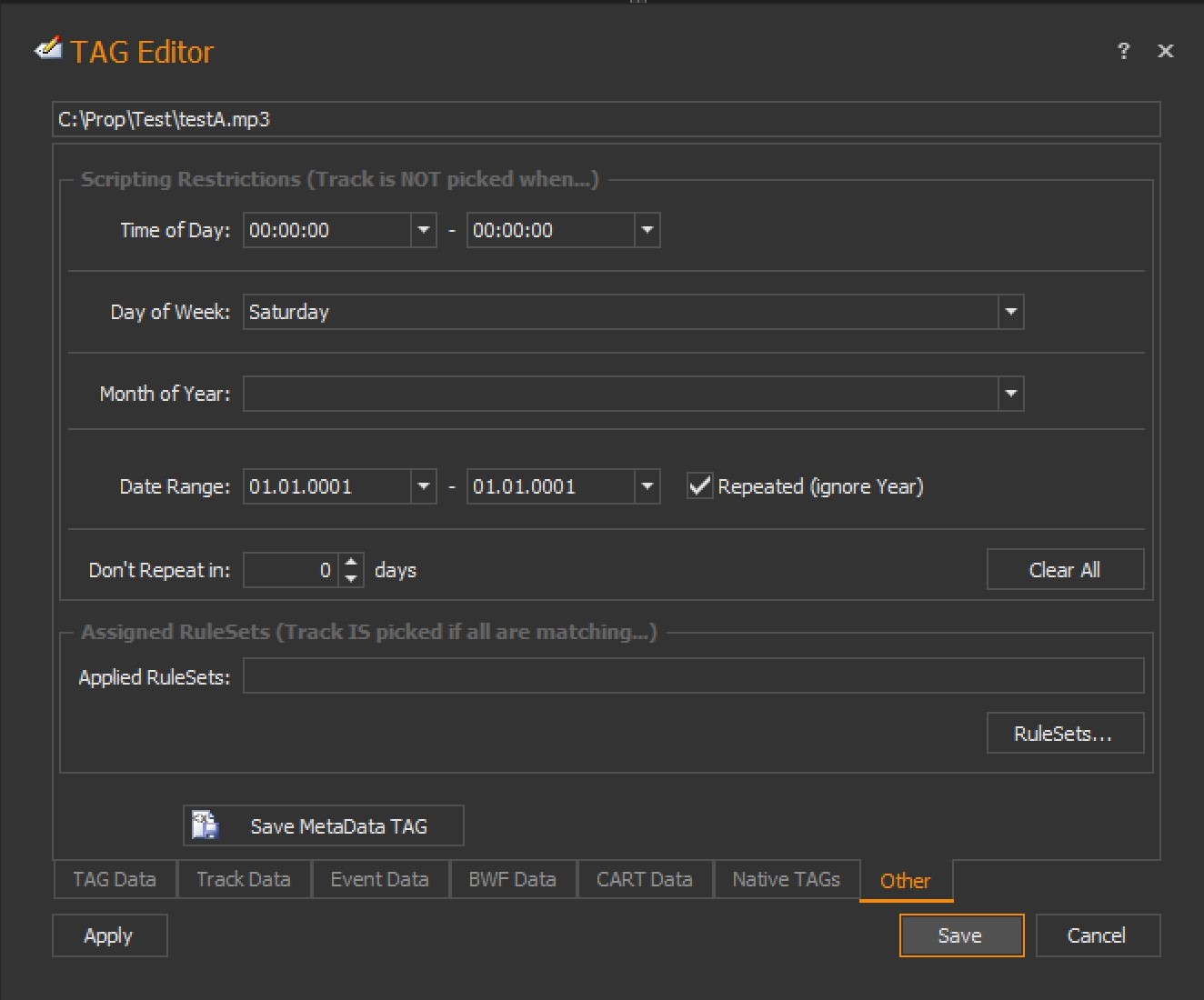

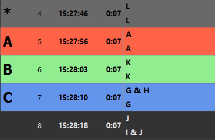

I even made a test and this also worked well (as said, nothing was changed since quite some time).
In the test, I created a small media lib with only 11 tracks.
For 1 of these tracks (track A) I did set the same track restriction as you did.
Then I created a small script which randomly picks a track from that library.
As today is Thursday, it should also pick track A...

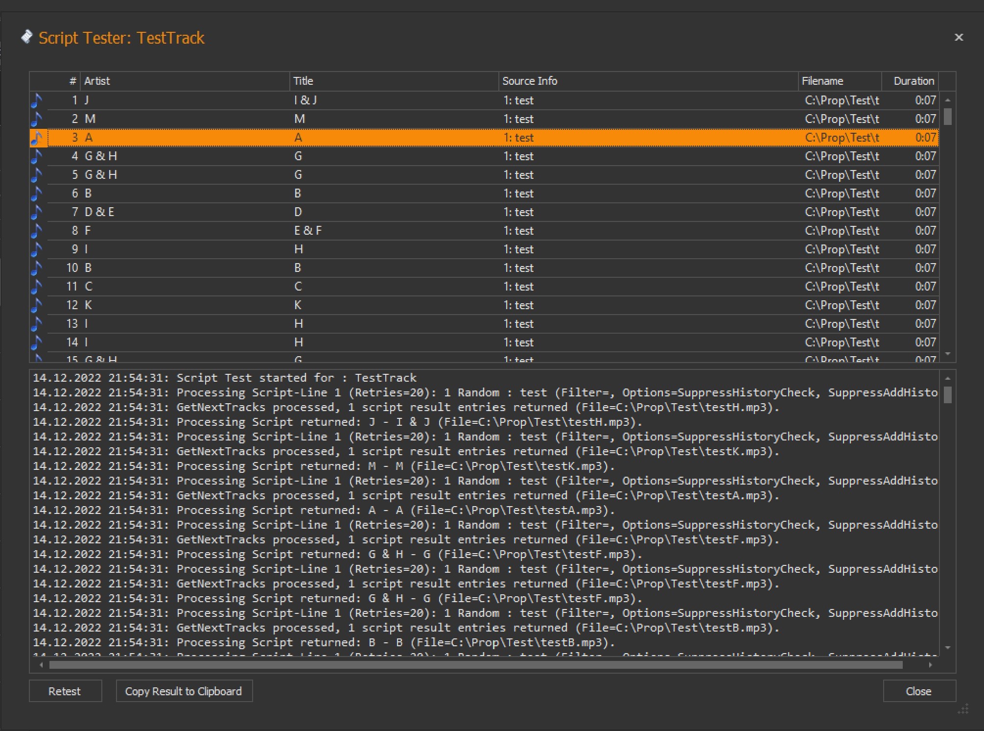

Here is the result (as you can see, track A is picked):

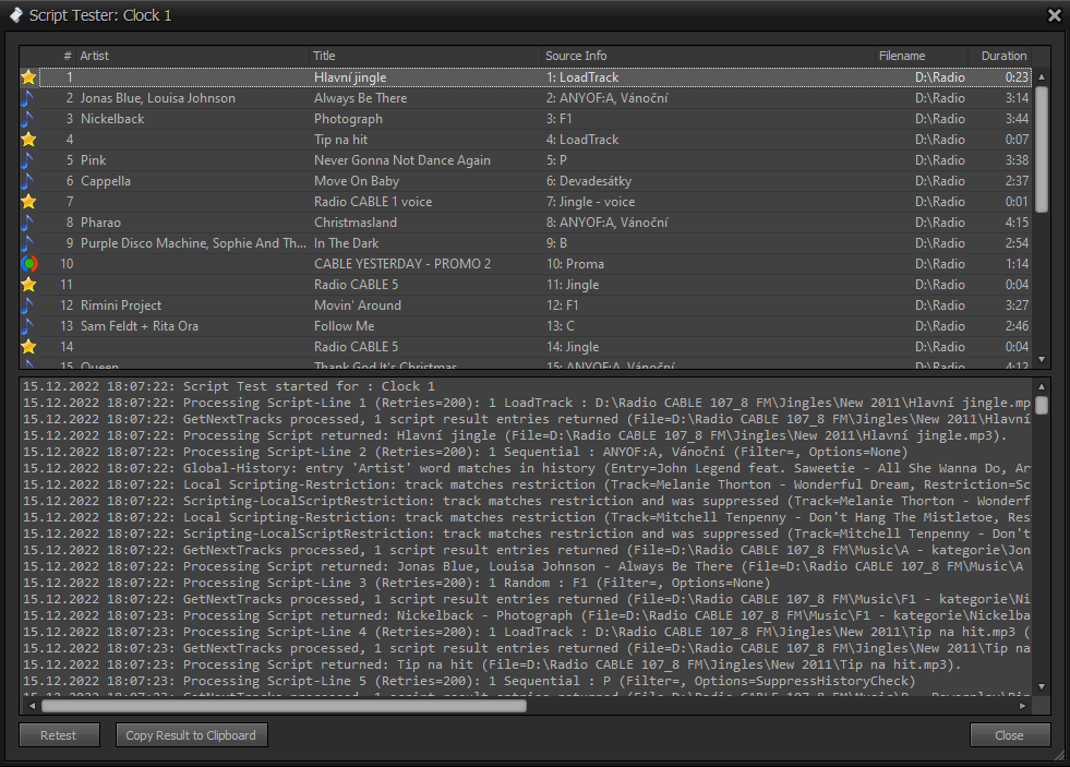

If I do a test script, it works. As soon as I put the script in the scheduler, it doesn't work onair...

Which track is in question in your screenshot?

I was also running the same in a script via the scheduler and this worked as well...
If you need to know, why your specific track will not be selected, you might turn on the 'Debug Logging' and the analyze the created Debug...log file.

It is about track 10. I will try to debug.
