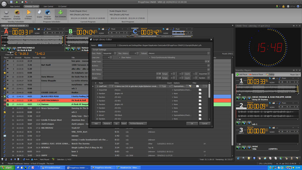

Re: How to: play top of the hour, followed by news
Thank you. That seems to be working fine. Altough, my script start with
1. TOTH-jingle
2. News
3. Stationcall
4. songlib 1
loop line is set to 4.
The THOTH-jingle and news is scheduled again, but in overtime.
1. TOTH-jingle
2. News
3. Stationcall
4. songlib 1
- proppfrexx_script2.jpg (133.48 KiB) Viewed 67325 times

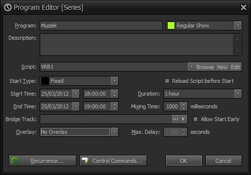

That indeed looks strange.
How did you came to the 'overtime' situation (how have you defined your program scheduler entry, if it repeats every hour...)?
And did you probably edited or reload the script which was currently used within the playlist?
Yes, I have 1 script that repeats every hour and during testing I edited the script while it was in use.radio42 wrote:That indeed looks strange.
After restarting the program the issue did not occured again.
- proppfrexx_program_schedule.jpg (28.65 KiB) Viewed 67312 times
