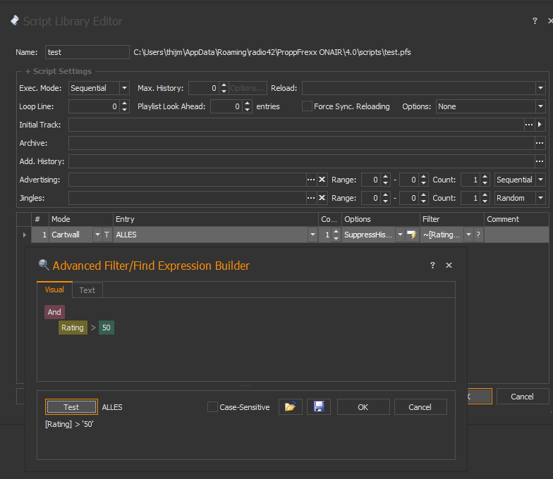

Hope I am at the right place for this report.
In a script, I select a Cartwall entry. In the Expression builder, I want to press the Test button to find potential entries. However, when clicking, nothing happens.
Any idea what this issue might be? Or is this not possible with a Cartwall mode?

Can you maybe show your exact Expression you are testing in a Screenshot.
Maybe the Expression is wrong, no media lib is selected, the media lib has no related entries…?
This is hard to say without further info…

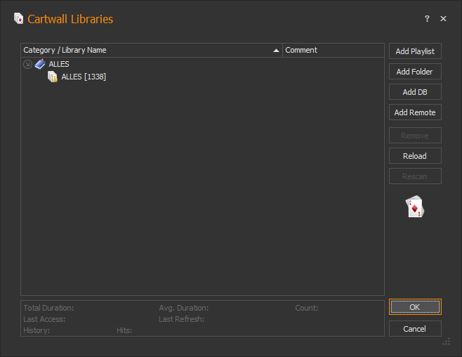

As you can see in the screenshot, there is a cartwall selected. The cartwall has over 1337 (
) items.

By the way: when I click Test in the Script Library Editor with ony one item (that one cartwall row), I do get results...
Re: Script editor: Test Expression builder for Cartwall
I will double check this... as it seems you are right, there must be some kind of bug for 'Cartwall' libs... this needs to be fixed!
But are you should use (for numeric comparission) the "Rating Value" field in the expression builder - but that is not the issue - as I just tested t here, and the test works fine for media libs, but somehow not for Cartwalls?

Yes, 100% sure, as the Test of the Script Editor does return items. No popup shows with the Expression editor. This does show for normal music libraries.
The "Rating Value" does not change anything. Every condition (filename starts with, for example) does not work for cartwalls.
