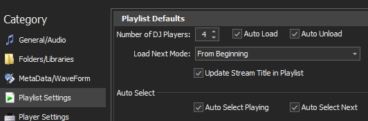

No, that is actually a feature. Let me explain:
In the general settings, section Playlist Settings you define the behavior for the Autom. Loading/Unloading state of manually created playlists, i.e. playlist not having a program/script assigned.
You are right, that for manually created playlists, that state was never honored, once you turned on AutoPlay!
I.e. once you turned AutoPlay ON, the Autom. Loading/Unloading have been turned ON as well (as this is definitely needed for AutoPlay to work).
However, it was never reverted to the default settings, once you turned AutoPlay OFF again.
Exactly this behavior is now consistently implemented. Which means, for manual created playlist:
- if you turn AutoPlay ON: Autom. Loading/Unloading is turned ON as well
- if you turn AutoPlay OFF: Autom. Loading/Unloading are turned back to their defined setting values
For automatically created playlists, i.e. playlists having a program/script assigned, nothing has changed and AutoPlay is turned ON automatically and as such also the Autom. Loading/Unloading is turned ON as well - and this is never reverted, even if you manually turn AutoPlay OFF.

The checkboxes in the settings are 'just' the default, to set the Auto Load/Unload option of the playlist.
Note, that each playlist has an Auto Load and Auto Unload option (see the related buttons at the left bottom status bar of the playlist window). So when you change any of these Playlist Settings in the general settings, they take only effect with the next playlist window you create.
However, you can still change the playlist related options directly in the playlist window by clicking on the buttons, as shown in the picture above; e.g. you can toggle the playlist specific option Auto Unload in that status bar.
